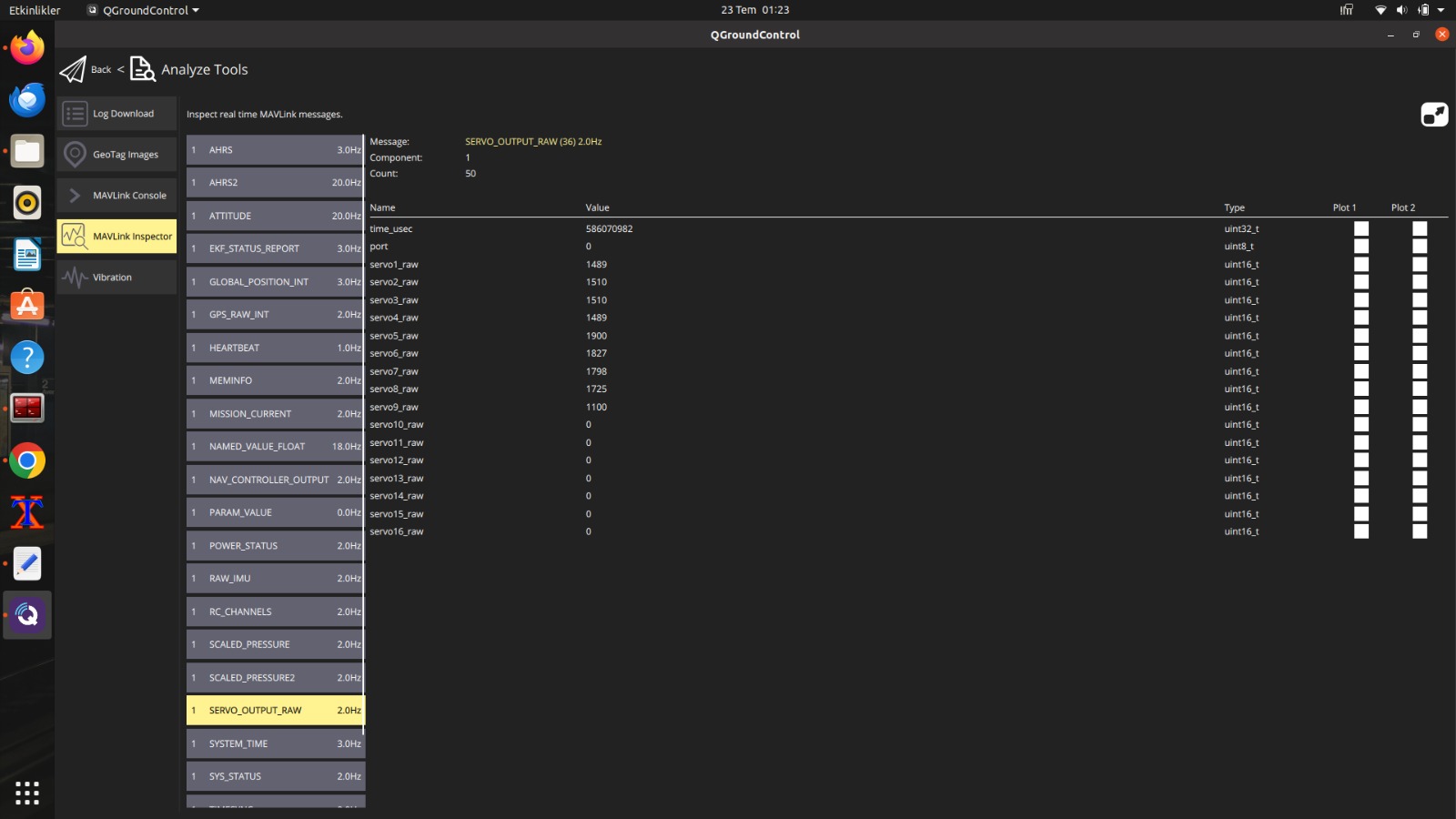

I am using an 8-motor underwater vehicle with ArduSub v4.5.2 and Pixhawk. The vehicle has 4 vertical thrusters: servo5, servo6, servo7, and servo8.
When I switch to Depth Hold mode via QGroundControl and monitor the PWM outputs, I noticed two main issues:
  1. Issue: servo8 PWM value decreases over time
While Depth Hold is active and the vehicle is maintaining a stable depth, the PWM values for servo5, servo6, and servo7 remain stable. However, servo8’s PWM value starts similar to the others (e.g., around 1735 µs) but decreases gradually after a few seconds—even though there is no change in pressure (depth), eventually dropping to around 1500 µs.
Since the vehicle remains stationary in depth, this decrease only on servo8 seems illogical.
  1. Issue: Large differences between vertical thruster PWM values
Sometimes the PWM values for the thrusters are as follows:
servo5: 1900 µs
servo6: 1740 µs
servo7: 1740 µs
servo8: 1500 µs
I don’t believe there is any mechanical imbalance on the vehicle. I don’t understand why there is such a significant difference between servo5 and servo8.
I monitor the PWM values both from the QGroundControl interface and using pymavlink with the code below. The values match in both sources:

Hi @beyza -
Without .BIN autopilot logs, it’s tough to advise on what might be going on! It seems likely that those PWM values are what are required for the vehicle to remain stable - is that what it does when in the water? If you’re testing in air, note that the control loops will always go a bit crazy, as the vehicle does not move from the thrusters outuput…
A couple of questions:
  1. Does the vehicle start out wobbling, and stabilise to level once that motor’s output is decreased?
  2. Have you checked that the thruster actually works?
    • When the vehicle is off/disarmed, the propeller should be able to move freely when spun by hand
    • If you try actuating just that motor in the Motor Test section of BlueOS (in Vehicle Setup / PWM Outputs), does the motor spin as expected?
