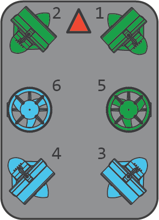

I use this frame :
I want to reduce the speed of yaw
