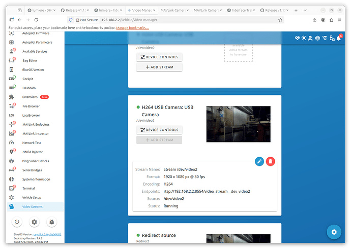

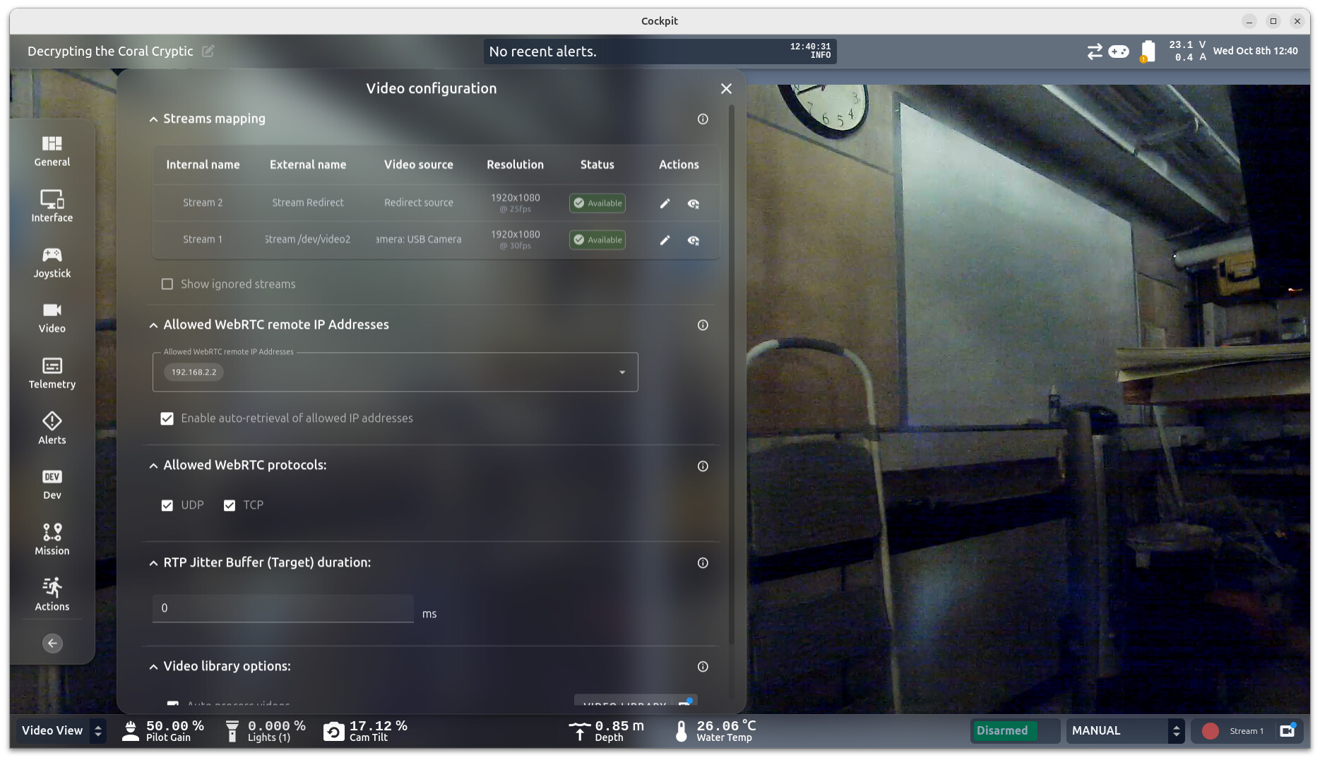

Unless you have both the original stream and a Redirect stream on MCM, the video is not going back and fourth. Can you send a screenshot of both your Video Streams page on BlueOS and your Video Configuration page in Cockpit (under the settings menu)?
I’m mostly sure this does not get optimized automatically at all.

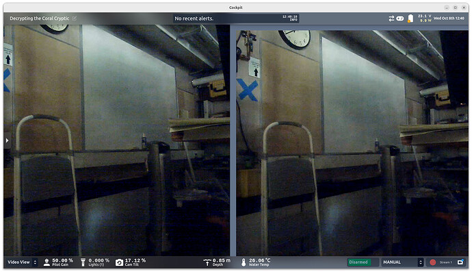

Sure. With mediamtx running on the laptop:
Here is the video pane in Cockpit, which sees both streams
And if I modify the interface with a second video widget, stream1 on the left, stream2 on the right
Unfortunately I am accessing the ROV remotely, I can’t move anything in front of the camera, however in testing yesterday I didn’t observe any latency between the two, which is very suspicious.

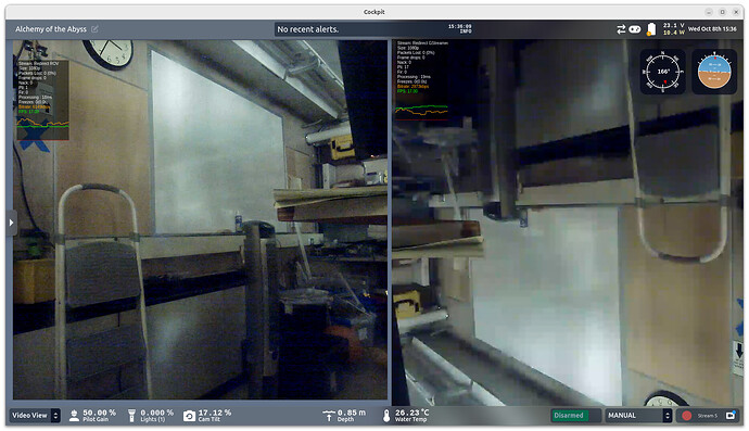

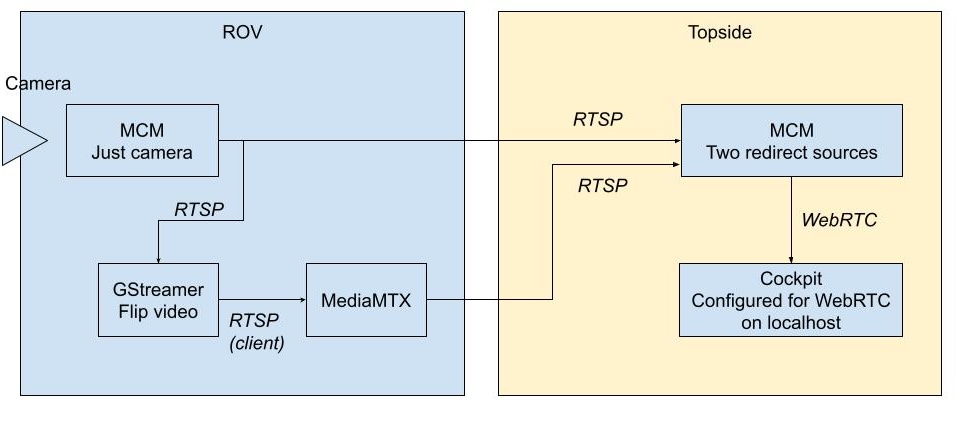

Here’s the block diagram. As I do not have the external camera configured right now, I introduced a quick gstreamer pipeline which flips the MCM video (RTSP in → decode → flip → encode → RTSP publish to Mediamtx RTSP server)
I configured MCM on the topside with redirect sources to the two RTSP addresses and overrode the default MCM address in cockpit.
As below, left pane is the first redirect, right pane is the second redirect.
Again, I’m not physically with the ROV so can’t check the latency effectively.
