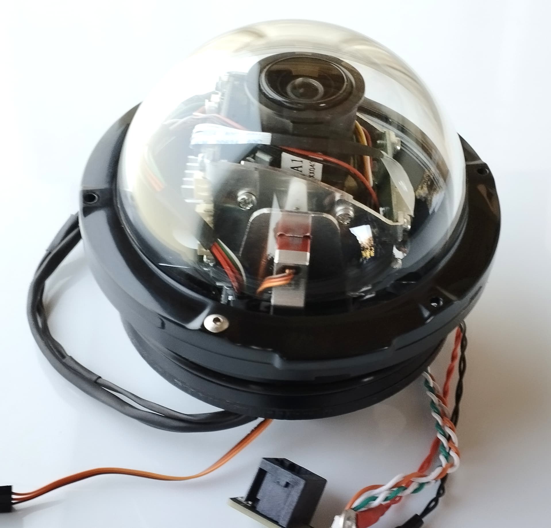

It is true that there are good cheaper options, it all depends on your needs. I mount another 4k 8mp 20fps camera, which can be installed directly on a BR2, it has a pretty good quality, but obviously it is not the same as this DAHUA. (Attached images)

This is not a commercial camera so I cannot send you the model, it is made with a 4k IP module, focusings board, SD module, and a fast focus lens. But then I leave you features and videos to see how it works.
This model can be installed on the normal 4" enclouser of BR2, without any modification (except for the use of an ethernet switch), just plug and play. Includes voltage regulator for power supply, servo, aluminum housing and methacrylate mounting plate:
Features: 8mp 4k 20 fps or 3072x1728p 30 fps/ Sony CMOs imx 415 ultra low light illumination sensor/ 0.01lux color/ varifocal lens 2.8-12 mm 4xzoom/ fast focus with screw stepping motors / bit rate up to 12,000 kbps / h264 or h265
