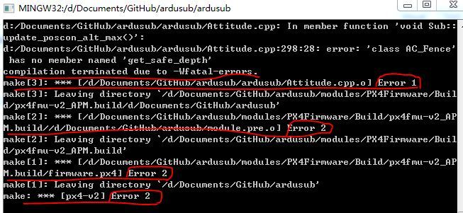

why the error occurred when i followed the instruction of compiling ardusub firmware? the prompt is followed:

For the build type to be determined correctly, I think the directory must be named ‘ArduSub’, not ‘ardusub’ as it appears to be for you.
Let me know if this helps -Jacob

Thanks a lots for your helps, yes, the error disappere when i follow your instruction, the compiling is successful
and attachment is the results. the reseaon is exactly to write wrong the directory name.
