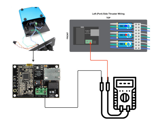

I’d guess the link light on your blue FXTI topside box is not staying lit after power up. Check the resistance of the tether pair used, and try swapping to another one if possible (both in the FXTI box and in the ROV.) This comes up frequently on the forums!

Verifying the tether pairs are connected and at similar, low resistance is key - if not, another available tether pair may resolve your issue. If that still doesn’t do the trick, you may need to replace one or both Fathom-X modules - please reach out via the help center.
