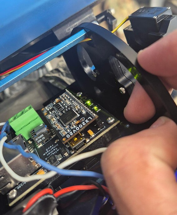

I took some photos of all the LEDs that are on. I can’t attach all of then on the post, so I put on Google Drive Folder: Blue Photos - Google Drive
Hi @Luis.Cardoso -
The link light on the Fathom-X in the ROV is not lit - therefore no communications will be possible!
It may come on after start-up, but go out shortly afterwards - it needs to stay on! You can check the resistance of the tether pair in use, and potentially switch to another one to get things working. Please share the resistance measured for each wire in your tether if the issue persists:
I don’t remember very well, but I think that when I took the picture, the tether was not plugged into the Fathom-X Topside Interface. That’s why the LED was not lit. As you can see in the picture below, when the tether is connected, the LED is on.
