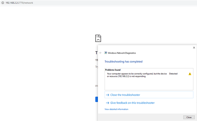

I have gone through setup over and over but no positive result, specific firewalls setting to suit setup but no change. Turn firewall off completely and still no change. Rebooted system, antivirus and bluerov2 several times but no change. Uninstalled QGroundControl and reinstalled but no change.

Ping seems ok, ip config seems ok, firewall seems ok

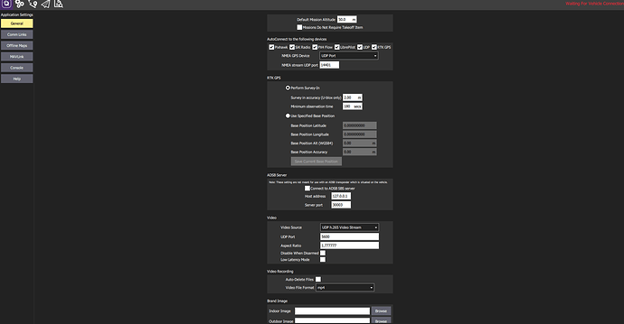

QGround Control - comms added to reflect port value no change, then port value changed to show video but waiting video feed!

Unfortunately not, disconnected from home wifi and retried but no luck. Also used my phone as a hotspot but no luck there either. Both attempts with antivirus turned off.
You network configuration appears to be correct.

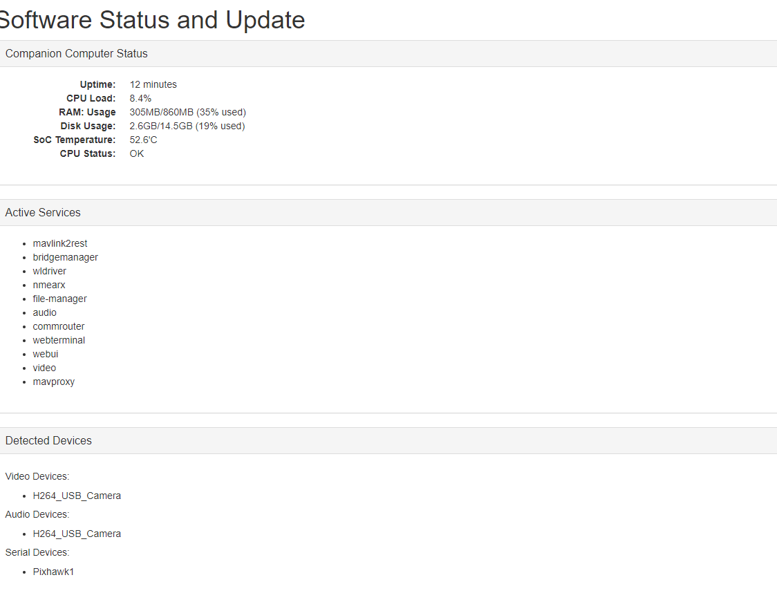

So latest update, flashed the raspberry on the companion, although only two files showing with current date stamp it appeared to partially work. I have managed to gain access to 192.168.2.2, no update required as no updates available.

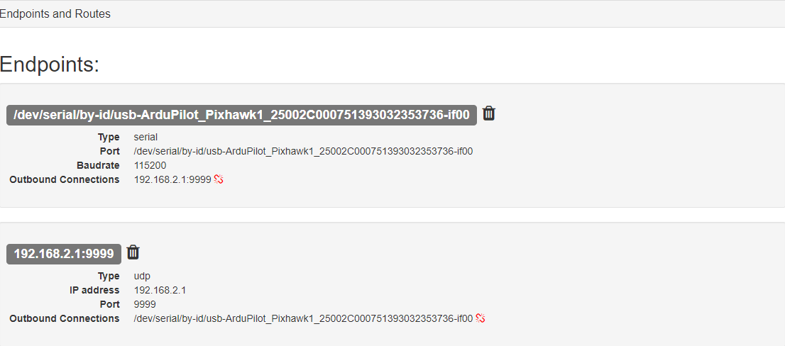

Also ran piraspberry command line screen -r mavyproxy but this keeps on going and with code i am unable to make sense off
