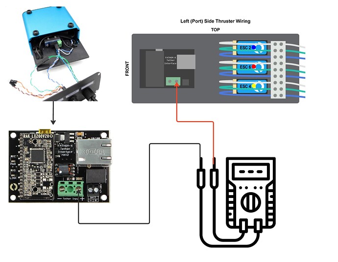

If you don’t have a solid green Link LED on your FXTI, you’ll never get connected! You can measure the resistance between the Fathom-X tether module used in both ROV and topside to verify your tether is ok, and try switching to another color tether pair (making the swap in both locations.)

I measured resistance (~42ohms) which I had thought was good. I switched to a different twisted pair (green) and both ROV’s are now working. I measured again and still saw ~42ohms, strange that they are the same but I assume the impedance is different. Has anyone hooked these up to a VNA and measured them?

Glad switching pairs fixed things! Sometimes the twist of a pair and the impedance may affect the connection, as you’ve found. I’ve not looked at the connection with a VNA before, that may be interesting. You can get a more in-depth look at things with the tether diagnostic extension installed in BlueOS!
