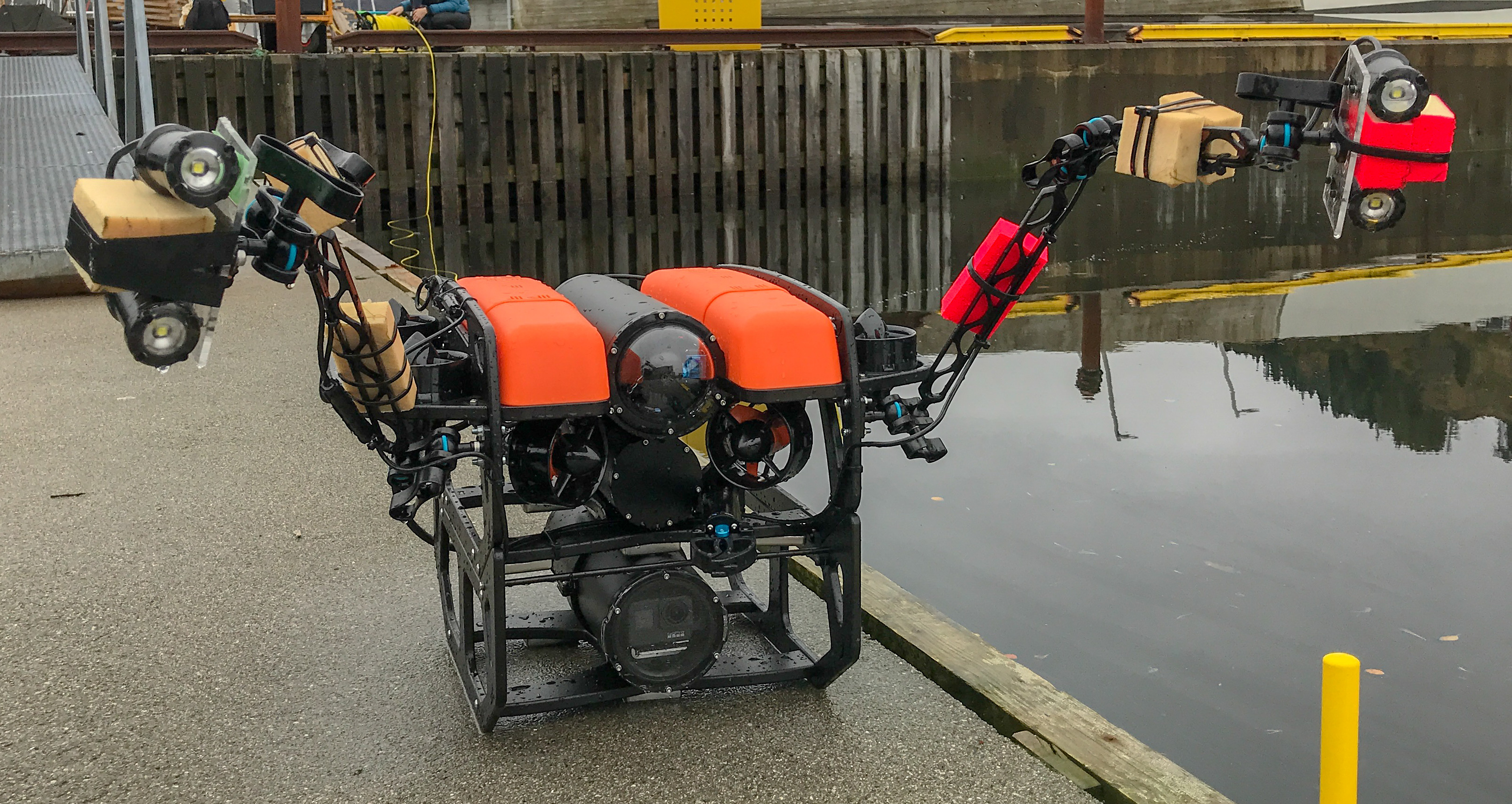

We’ve done this using standard nauticam arms. For our setup is has meant lengthening the cables for the lights and also installation of a filter to remove electronic noise from the signal wire to the lights: i.e. to make sure the lights still receive the proper PWM-signals through the longer cables.

My latest design has those sort of arms which swing out via a servo, with LED lights on them to get the light out to the side to reduce ‘backscatter’.
I can extend them when i need better lighting, then retract them if i’m getting into a spot where they may get hung up, or if i’m surfacing.
I would never bolt on fixed arms, sticking way out to both sides. That’s just asking for trouble.
