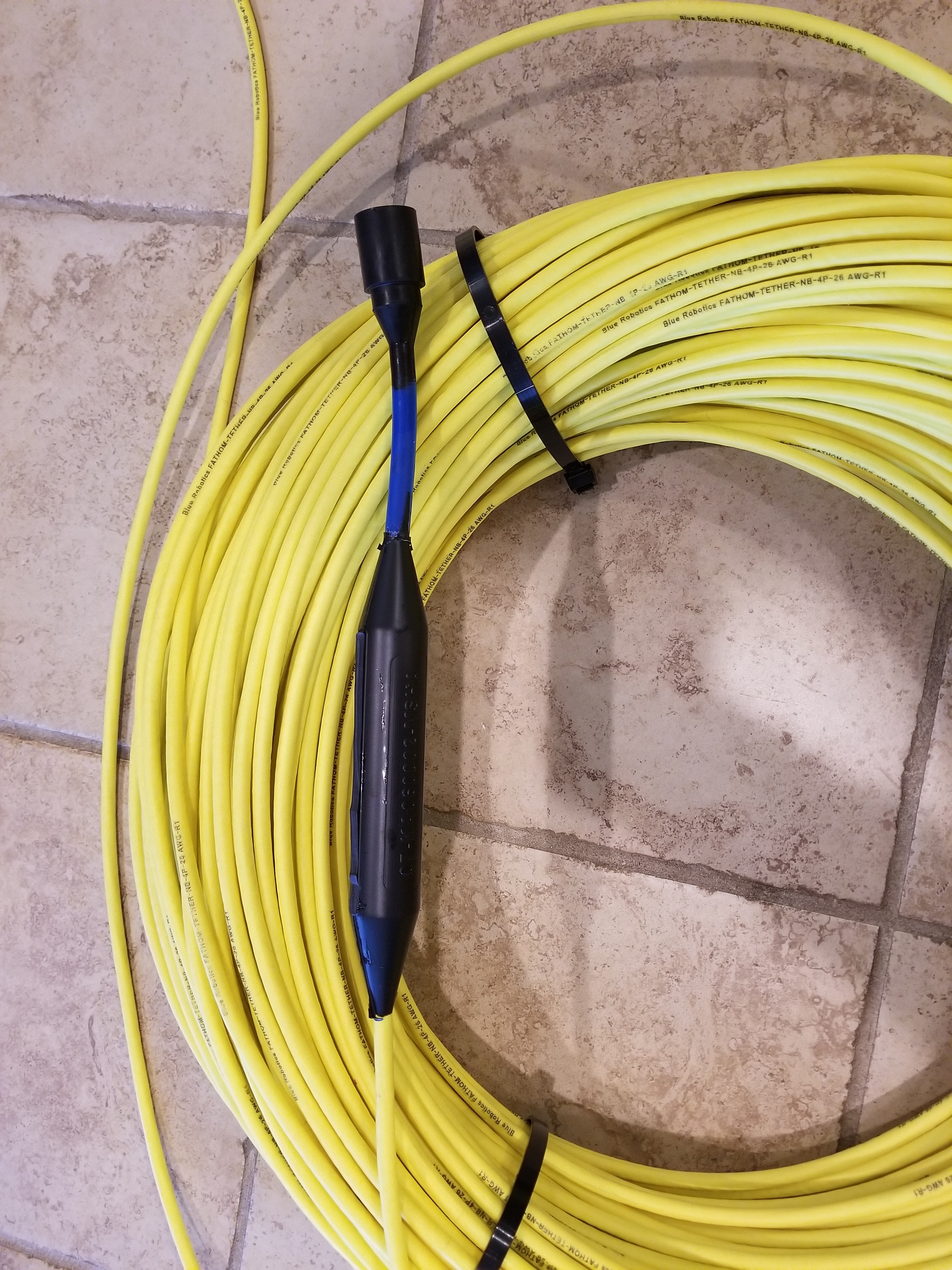

The info on this forum is great - Thanks. I used the SubConn 8 pin splice with the Scotchcast. Then a SubConn bulkhead 8pin on the ROV. Went 1/64" larger than the 7/16 thread and it worked well. No issues using a drill press. In retrospect I am wishing I put a Kellem’s grip on like @SHS.
