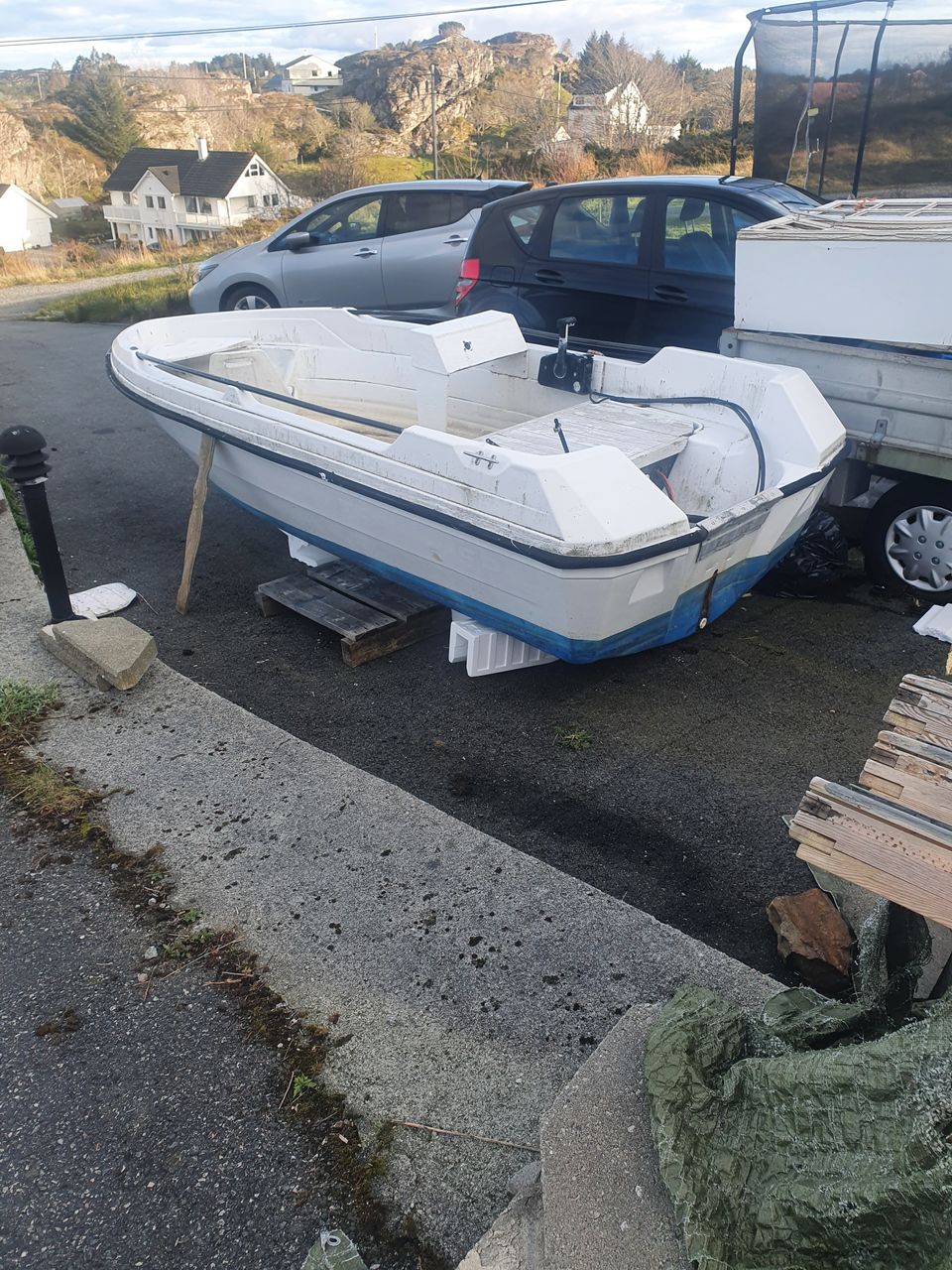

and two new boats are on the line… small and handy with a 20HP outboard, and last but not least… Viksund combi 25`…engine is not cleared yet, but seems like a Mercruiser 200hp… we are fast, effective and saving lives while waiting for the moore serious future… still this is missing me as much as im missing this…BROKK 150… cant beat that, subsea… decomission will see another level og effectivness… now its just up and forward,as my boss asked me, soo how are you shure about this??+… I ansvered, can anyone do it better than us?..after 5 sec, he just said NO they cant, god point,9… ![DSC_0611|690x460] …our team is getting beyond Solid, have never been together like this and this si definetively some of the worlds leading Pilots and tecnichians, there is no seecret that we are high in competence in Norway so;)… …just have to get rid of that CORONA VIRUS, IS STALLING ME LIKE A chineese ROV factory;DDD (upload://v0NEZ5WIENF0vCSHSEaIw3VQLea.jpeg) Stay helathy Al of you and will keep you updated… 1000m is close, must just make the boyancy moulds, so 5 systems are mde simultaius,9 …WAS NICE TO CRACK SYMATEX MIXTURE CODE,ddd! DSC_0621|690x460 …lokinf for a small lorry crane for this boat… . increases the income Anyway;)…will be a winch and TMS SYstem also, but there is a lot of space in the back… and the oat is Rock solid, the old Man Erling is Still making Niice boats for work and recreational use… just went up a nudge this tIme(Nooo not yhis boat. )…sharng a hint of my propellers that im currentky working on<.
