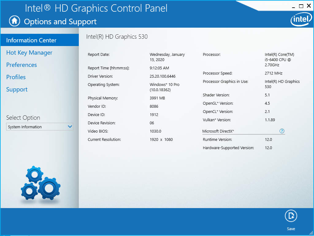

    For No.2,3 Maybe the vdo resolution was not suitable for my surface computer >>> How can i reduce the resolution or quality of streaming VDO ?? , or if you have any advice for solve my problem please tell me.
    My computer spec.

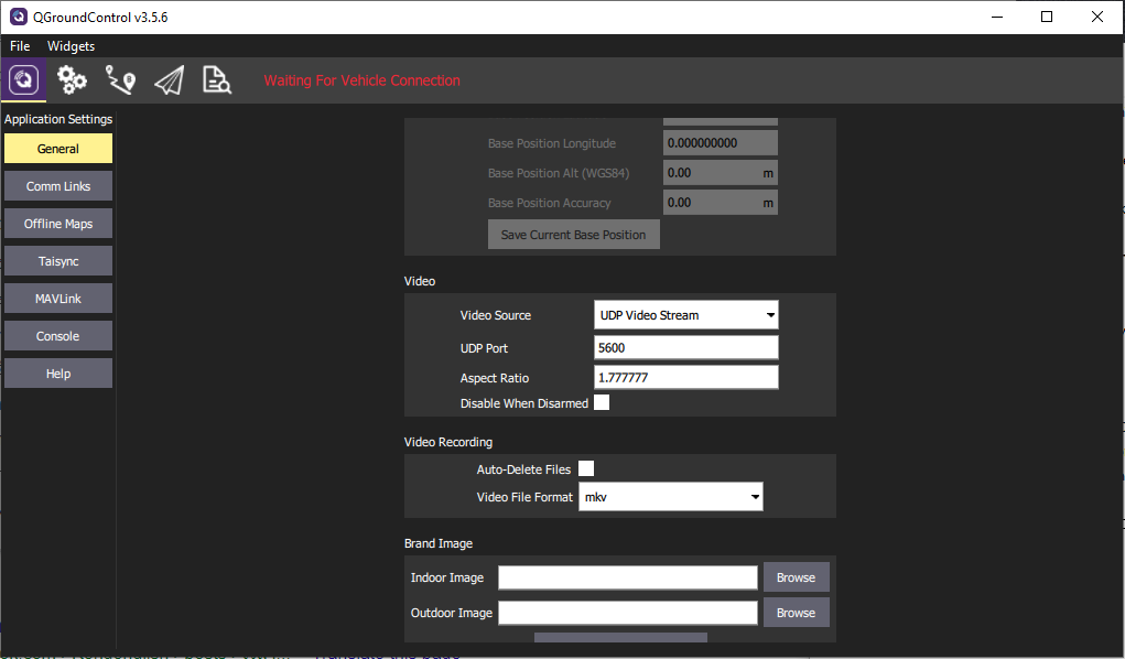

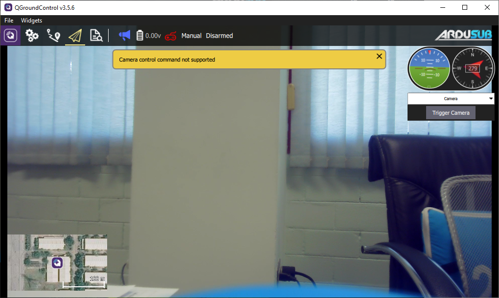

Ok, I change IP on camera config to 192.169.2.1, this is my IP for my Laptop
and this is the VDO result.
and some time .
Hi,
Check our troubleshooting guide for Poor video streaming performance.
