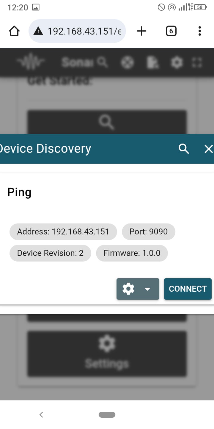

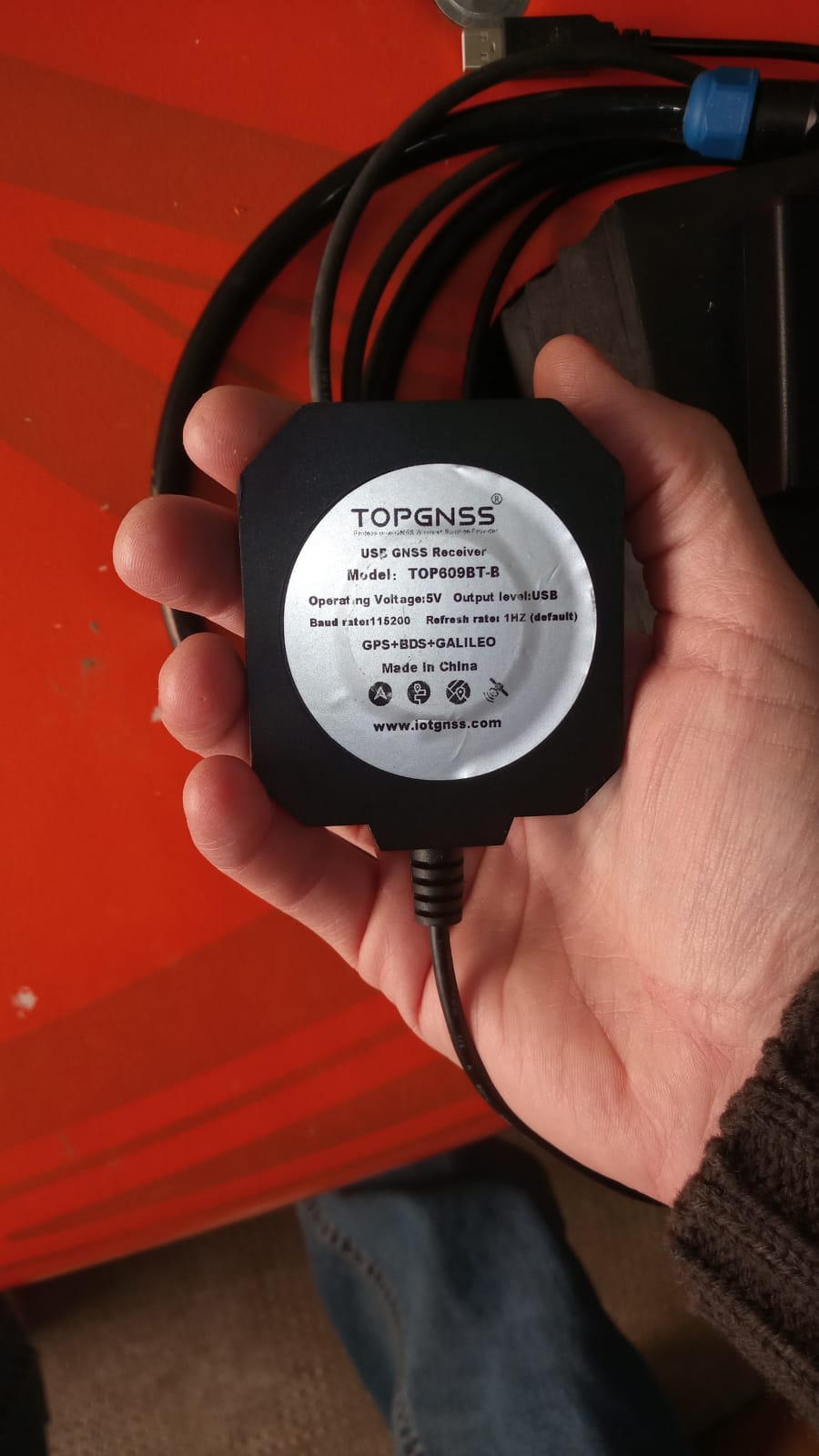

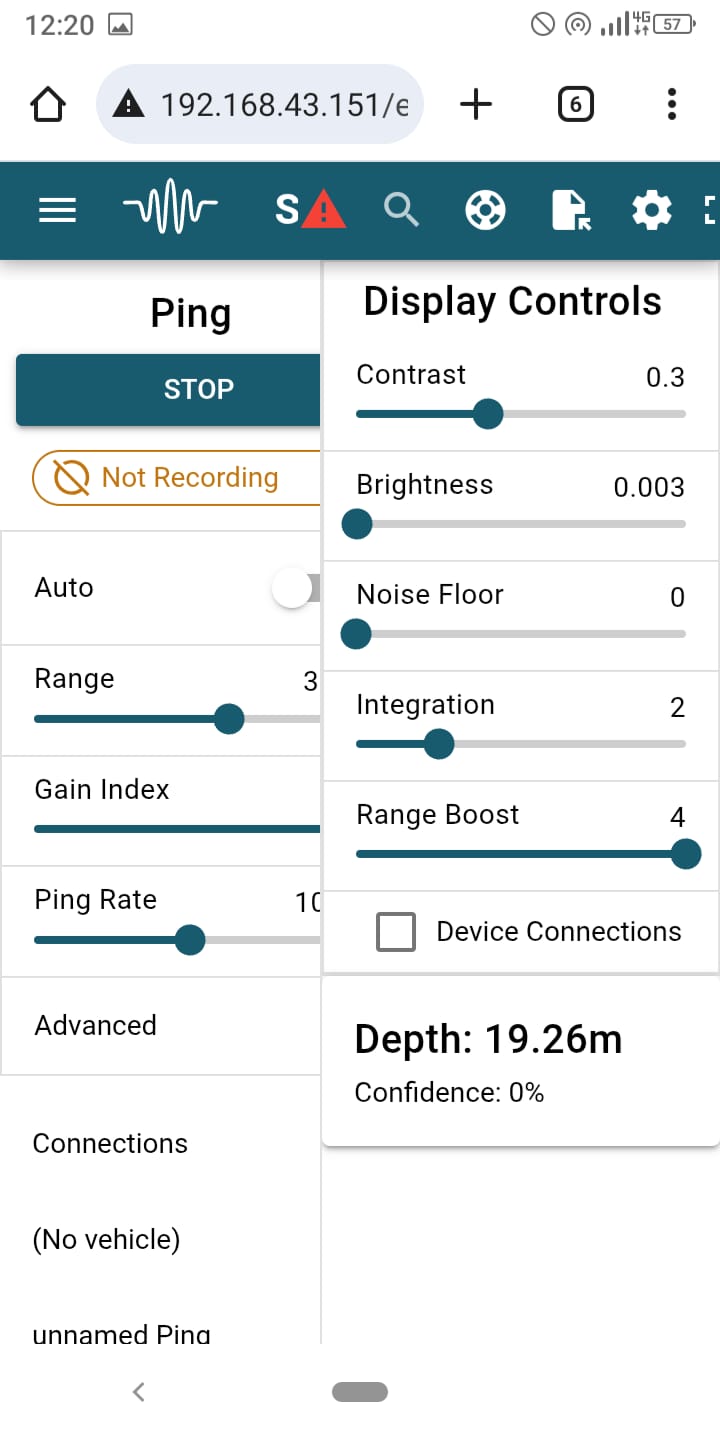

Based on how I wired everything and configured the port settings, the GNSS is detected correctly—when I open Cockpit, I see the boat’s position in real time, and in Sonar View I can read the real-time Ping sonar data.

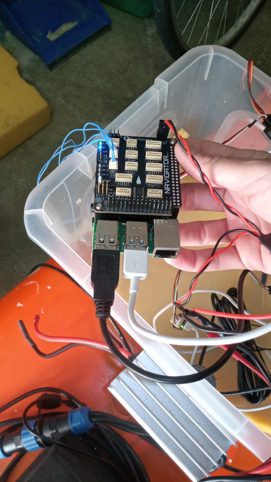

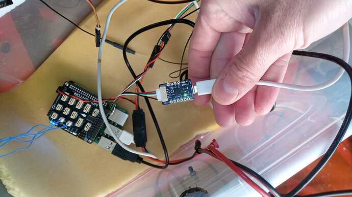

I’m attaching some photos to show how I wired the system. As you can see, both the Ping and the GNSS are connected via USB.

SonarView works to view the Ping data- however its logs won’t include position by default.
I developed the Simple Ping Survey extension for your application - logging depth and confidence alongside GPS position to a .csv file, while visualizing the data on a map. Simply install, and make sure you’ve enabled mavlink messages under the ping sonar devices menu. A full guide on the setup is here.

I tried using Simple Ping Survey again, but even though I enabled MAVLink messages under the Ping Sonar Devices menu, I don’t see any data in the extension—not even after clicking START. Specifically, the map does not appear, so there is no position shown, and no data appears in the log at the bottom.

It sounds like you don’t have the GPS configured correctly- does your vehicle show up on the map in QGC or Cockpit?
If not, you’ll want to add the USB port to the autopilot, selecting it under serial 2 on the autopilot firmware page in BlueOS, in pirate mode. You can then set serial 2 function parameter to GPS, and GPS type to auto under autopilot parameters.
If you can share a screenshot of that configuration under autopilot parameters we can make sure it looks correct!
As for the Ping sonar, can you navigate to the available services menu in pirate mode, and check the mavlink2rest interface to verify you’re getting distance sensor messages? We need the autopilot to recognize the Ping is connected.
