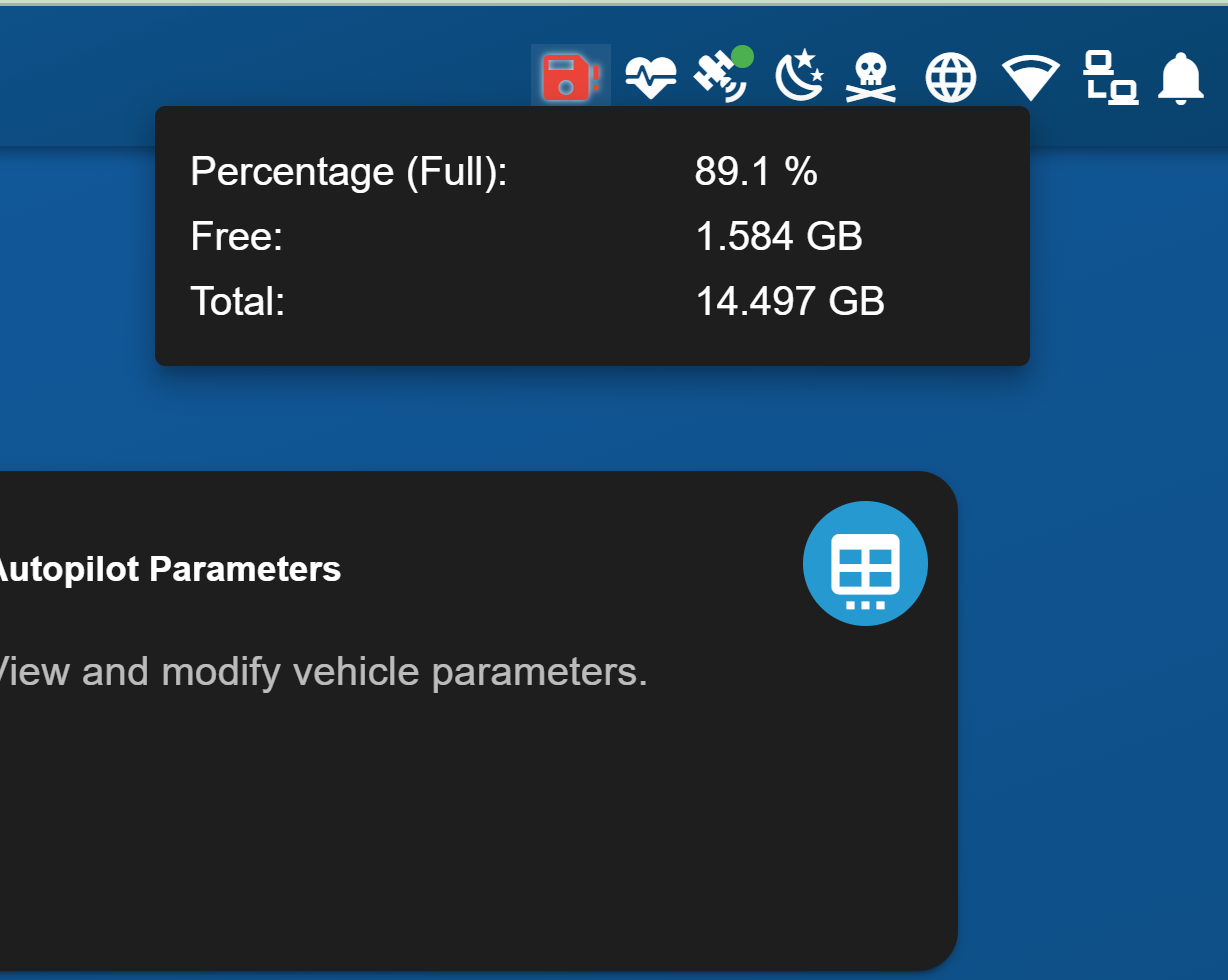

Greetings All,
I have a BlueBoat with the original 16 GB SD installed. When I log into BlueOS it has a flashing red disk with an exclamation point flashing. When I click on it it says that 89.1% full, Free: 1.584 GB, and Total 14.497. I thought it would be a good idea to get a new larger card to end this message. I have a 64 GB card that I formatted in NTFS, and cloned the existing 16 GB card using Balena etcher. When I insert this into the BB, it starts up with all my setting, but still has the flashing disk with the same percentage full. I would prefer not to have to completely setup the boat from scratch. Is there anyway to extend this to use the full storage of the card? Thanks!
Cheers,
Ian
Hi @FairweatherIT -
This guide has the info you’re after!
Click the button for “cloned my SD card”
Thanks Tony! I knew there was a way! Always great to get help from you!
