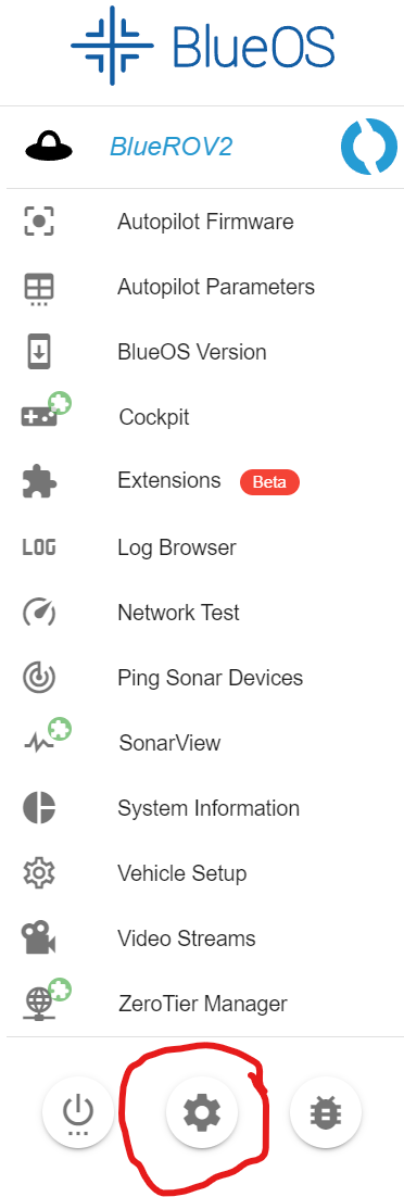

A video or log files (.bin from Ardusub (log viewer) and BlueOS logs (bottom left, gear icon, in BlueOS) would be helpful in understanding the issue.

Thanks for the autopilot logs. Can you share the BlueOS logs as well? You can find them here as mentioned, it will be a system_logs.zip file.
