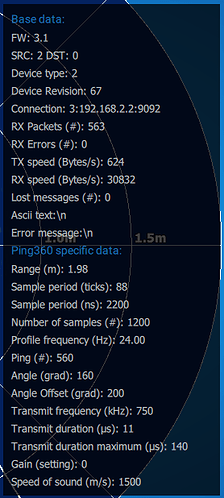

We normally use ping360_bridge_manager.py on our companion computer, which runs a compiled bridges program, which has decent results for me:
