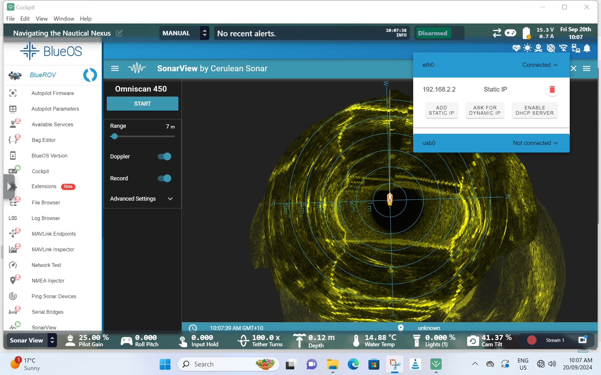

Thanks Dan - Tried 192.168.2.2 as the vehicle address in Sonarview Discovery
with no luck. Have attached the last couple of Vehicle logs as well as a couple of logs from the Ping1D running on Pingviewer. Attached a screenshot which seems to show the vehicle has a static IP 192.168.2.2. The screenshot shows the network is connected on eth0 but not usb0. I’ve always wondered what usb0 is for - do I need to have that connected?

In the previous screenshot, I see you put in 172.0.0.1 instead of 127.0.0.1 so try that one again. In the latest screenshot, I can see that it’s not successfully getting positional data from MAVLink.
