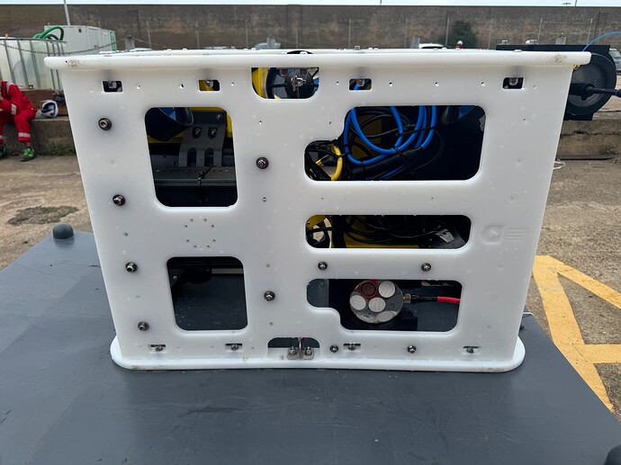

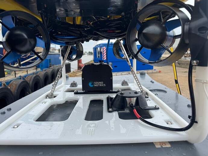

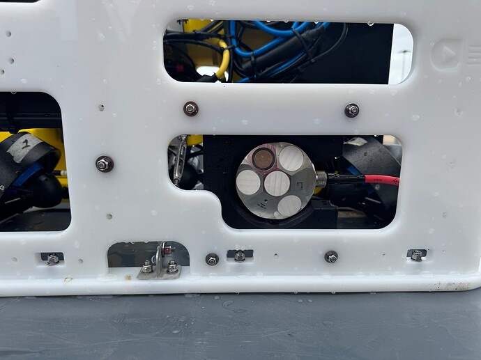

Hi @RoryF_Nortek ,
We’ve currently integrated your DVL onboard our Rov VECTOR but we’ve encountered some configuration issue.
We’re able to connect to the dvl through the blueos extension.
We see the skipped packets.
But…
Into the integration manual it’s stated that “ In order for the controller to accept and utilize the velocity packets sent from the Nucleus, certain parameters has to be changed. The parameters and their required values are presented on this page.”
I haven’t found them into the github page.
Can you help with it?

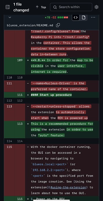

Hi @SubseaLED,
Clicking your link, it seems they’ve updated the README (6 hours ago) to include the parameter values you were curious about :slight_smile:
I’m wondering why they removed the commands to autostart at boot and automatic restart the extension.
Hi Davide, the commands has not been removed and the extension should start up the same way as the previous version of the extension.
Are you adding the extension through the extension manager in BlueOS?
Yes extension has been installed with the extension manager.
But as usual require to manual connect to the dvl setting the ip address and then start the packets forwarding through the switches .
What’s the best way to auto connect and having the DVL ready to work as soon as Blueos boot up?
