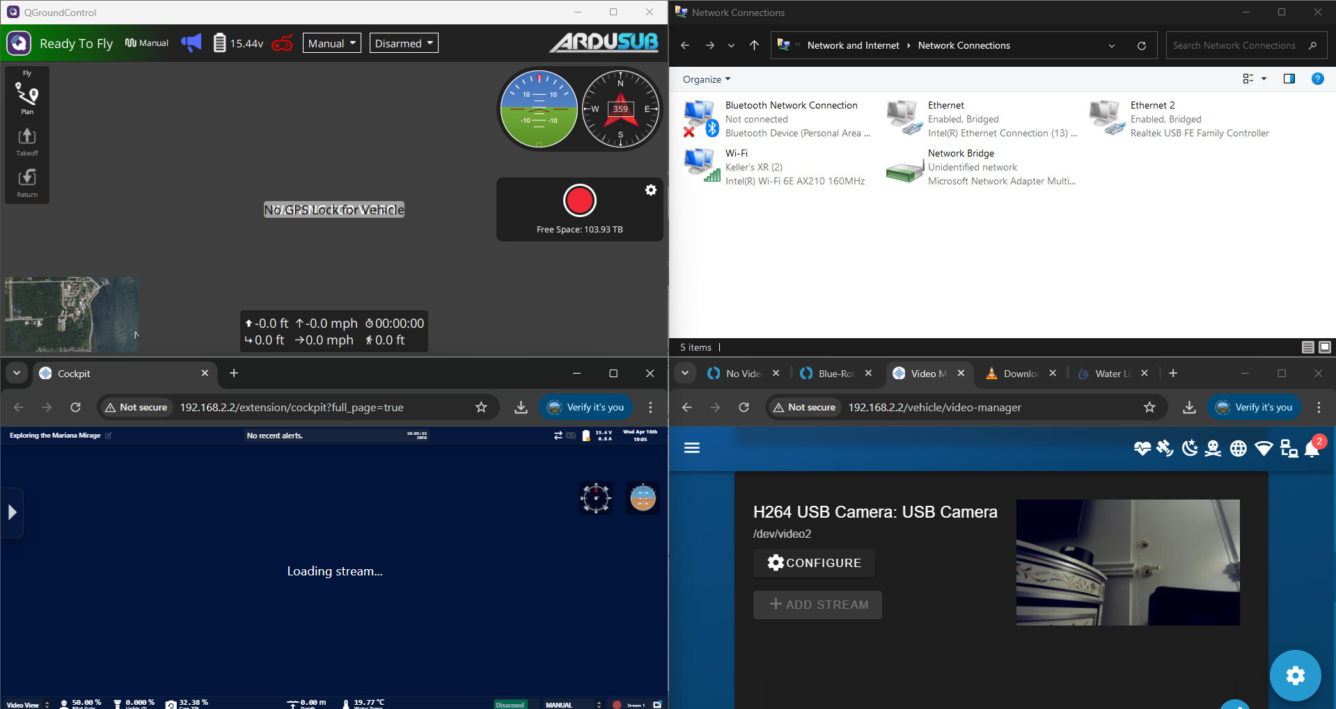

Hi Tony, thanks for the message. I gave the RTSP a shot. Here’s a screencap of QGC, Cockpit, Video Streams Page and network when bridged at 192.168.2.1 at default subnet mask

That was on 1.3.1. When on 1.4:
UDP H264
Network bridge
No bridge:
RTSP same thing, and UDP265 breaks the stream:
& no camera shows up in video streams.
When setting the bridge and refreshing cockpit, I get the following:
I’m not sure if that means that it see the stream but fails to put it up.
