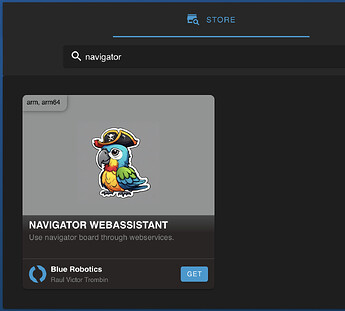

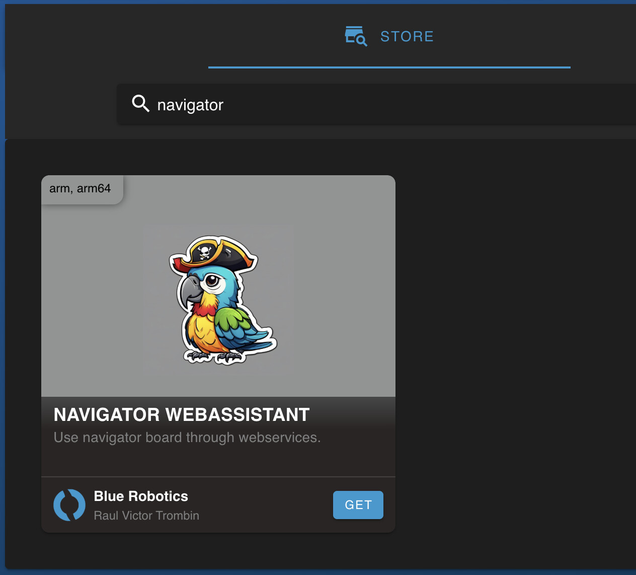

Are you using a Raspberry Pi 4, or some other board? It seems to appear fine here on BlueOS 1.4.2:
