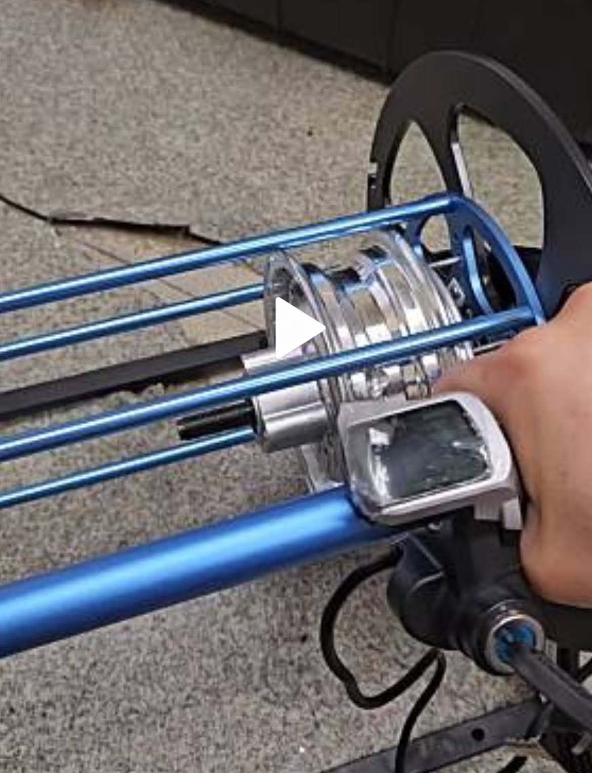

After installing the system and testing it by winding the cable, I noticed that the frame is too weak.
It seems that several reinforcements or modifications will be needed to make it work reliably.

We have built and are using it.
However, the frame’s strength was too weak and it bent.
We are using 6mm cable for 1000m.
Therefore, we changed many parts of the frame to aluminum.
The price became too high, so we have not proceeded to sales.
