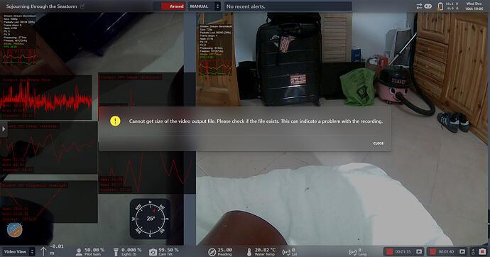

I was carrying out a survey inspection today using cockpit with two cameras and recording both video streams. Now I came ashore and tried to process the videos they will not process. I am hitting “process videos,” the top bar goes green and works its way along then when it is near the end (right side) it turns red and comes up with message … video processing failed …….
This is the first time I have used Cockpit in the field, and as you can imagine, not being unable to view the video footage is very frustrating.
Is there any way that I can retrieve/process these videos now ?
I have not deleted any of the video chunks.

Hi @Mac1 -
What version of Cockpit were you using? And BlueOS version?
Processing the videos should only be necessary if they didn’t record correctly - do you not have any recordings in your home folder, under Cockpit / Videos? The home folder is one level above your Documents/Downloads folders.
If you still have the video chunks, newer versions of Cockpit should process them with the built-in tool…

How can I recover the video chunks ? When I updated the cockpit to V1.17 the previous days video chunks were no longer available to process ? Then I reinstalled V1.16 and the video chunks are still saved in their folder , but I do not know how to process or transfer them into a viewing format ?
please advise
Hi @Mac1 -
On version 17 (or the latest beta 18) you should see the processing tab in the video manager - does anything appear under it?
Hello Tony, is that the 1.17 version that was released on the 25/12/05, I cannot see where it says beta 18 , or is that a newer version/
