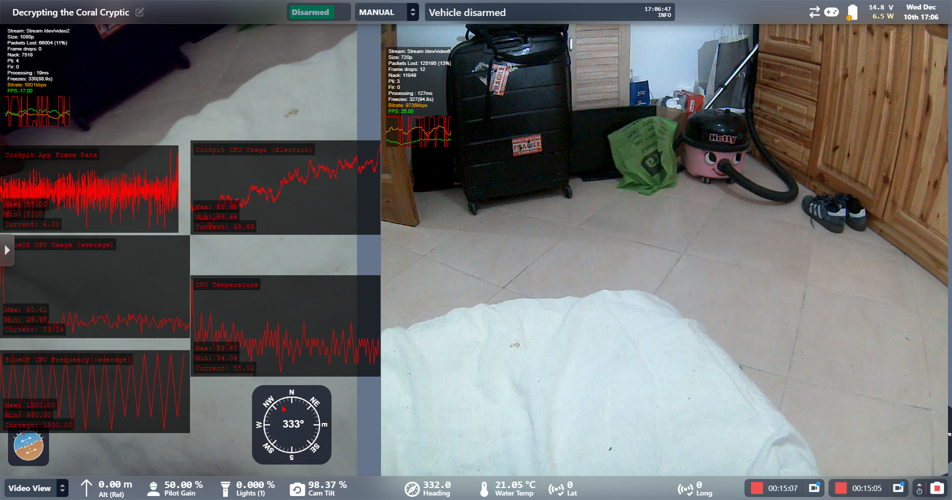

I also got a MYGCS:255 Heart beat lost message
Can you check if the video recording file is indeed not growing?
this is what is coming up now when i try to record a stream
Cannot get size of the video output file. Please check if the file exists. This can indicate a problem with the recording.
getting this now , but both streams are almost frozen
Recording for stream ‘Stream /dev/video6’ has stopped. Stopping health monitor for this stream.

Could you test it for more time and stress the system? Yesterday we were also able to get a 10min recording with you on v1.17, but at some point things got worse.
And looking at the stats for nerds in the video players, both still show >20% packet lost, making it clear that there’s something going on on the vehicle or in the communication link.

started the second test , packets started off on USB at 11% and on the DWE 12% , went up to 12 and 14 now dropped back to 10 and 12
15 mins and all 3 still recording , with no message issues
30 mins all 3 recording no issues and packets stabled at 11-13%

40 mins all 3 recording and Packets settled down to 0 %
the problem with the messages about recording not growing is that when it starts it becomes constant and has to be clicked/closed off the screen all the time , making any ROV inspection difficult to concentrate and close off messages all the time , also in the 1.17 version , it was difficult to pan and arm the ROV , but I will try uploading it again tomorrow and let you know if anything has changed in the mean time , but reverting back to the previous version was an instant fix and packets % reduced the more I used it
