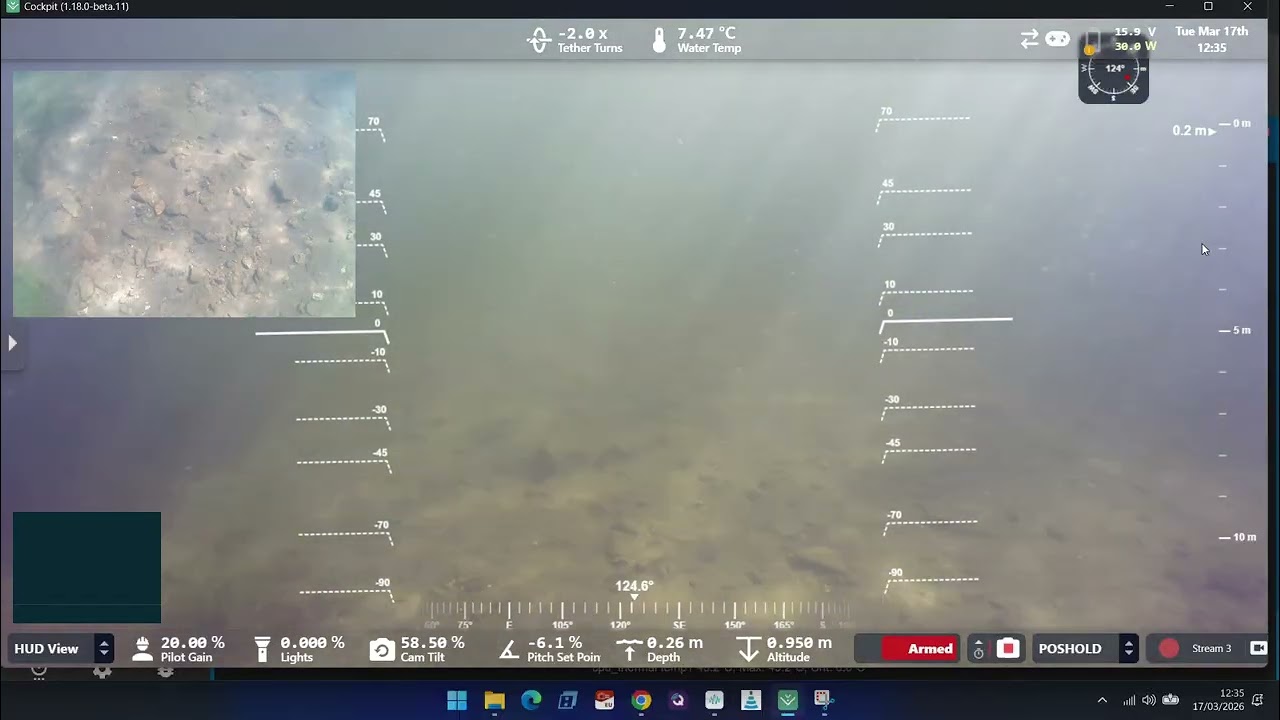

Tried on two ROVs today. ROV1: the recording was fine on the first scan, however second scan once again did not save. Additionally, Cockpit experienced huge lag during & after second scan. The geek tools display was showing the connection to ROV was fine, so assuming a cockpit issue. The lag was 3-5s from control input, to action.
ROV2 only did one scan, so did not confirm the second scan not working, or the lag.
On another note, there was a huge delay on voice playback (eg. “Gain 30%” voice playback after changing gain to 30%), when I say huge, I mean 5-10 mins delay.
For confirmation, this was running the beta you posted above.
Update - Both ROVs stopped recording at 888 images

And finally…..the past few days I have been testing Beta 11, and the previous situation of (around) 888 images being the maximum record. In the video you’ll see that I move the images from the snapshot folder, to another, then re-start the record, to no avail. I found that the only way to continue the data capture, was the ‘land’ the ROV on the bed, move the captured images to a different folder, do a full re-boot of the ROV and re-start Cockpit, then it was good for another 888 (or so).
Thanks for the extended tests! That makes it a lot more clear.
And the hypothesis of Cockpit running slow is indeed confirmed, as can be seen by this plot:
I’ve drawn the blue line for reference. That’s where the pink points should all be. Your Cockpit instance is battling a lot to keep running. Your average is 34 when it should be 60, and you have several drops to zero or close.
