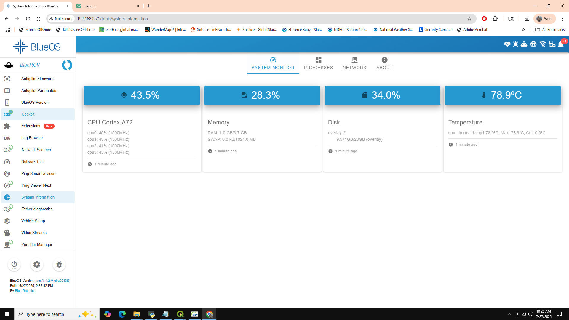

I noticed that our CPU temperature climbed to >70C degrees during dives. I started bringing the ROV into the air conditioned cabin on the boat between dives, but I still saw almost 80C a couple times if I left it running during short (5-10 minute) surface intervals.
I noticed that I had some really high CPU usage by a few processes a couple times when I checked. See below. Sometimes the percentages would jump even higher for a few seconds.
I am almost certain that our connectivity issues started when temperatures were high and the battery voltage had fallen to around 12.3V. After swapping in a fresh battery and letting the ROV rest for a few minutes in the air conditioning, the ROV was usually OK for a few dives. Only later would connection issues occur.
Question: Are these temperatures and CPU usages normal?

The process view in BlueOS doesn’t quite show the right cpu% - this is a known bug being addressed. You can get a more accurate idea of things by running htop in the terminal (may need to take the red-pill.)
