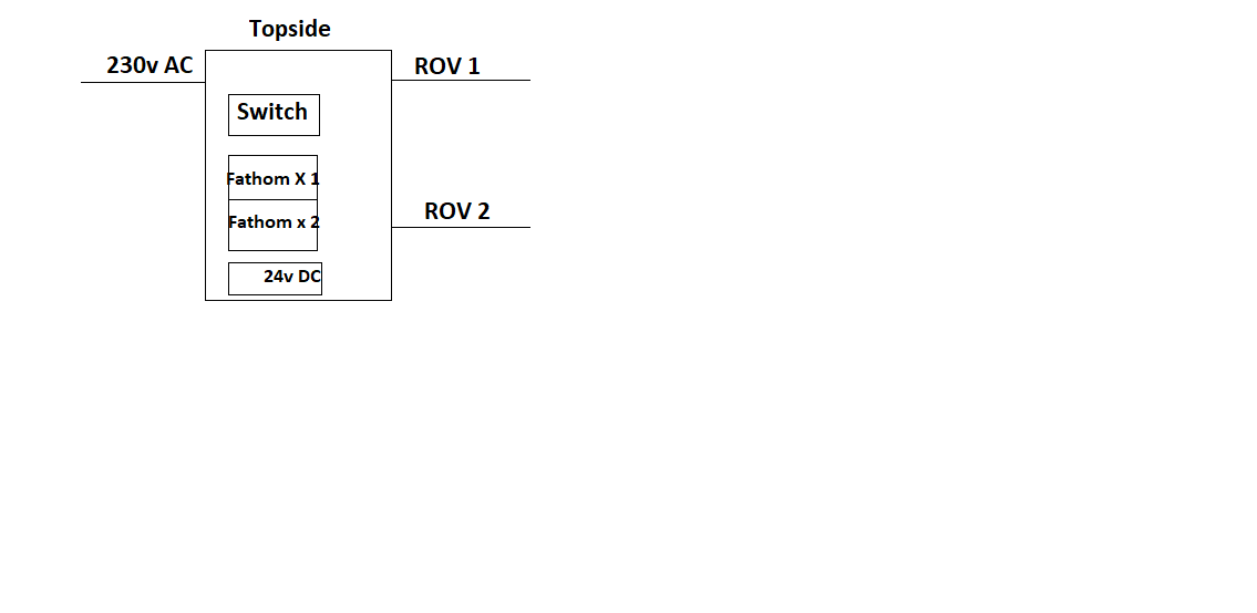

I have an issue with fathom X are connecting through the DC bat. With no rovs connected to the topside the lights on both fathomX are on. I thought they only linked up between tether input. How is this possible? Is it possible to fix this problem?
I want to connect both ROVs on the topside box and through my network.
Both fathomX on topside are connected through the same DC power supply.
The lights on the Fathom X will come on even if you’re ROV isn’t powered up. Your switch will recognize the Fathom-X as a device and the connection lights will indicate a connection.
I’m curious - are you connecting two BlueROV2’s? Because if you are, there will be a conflict in the network as they both have identical IP addresses, as well as the PC’s that operate them.
