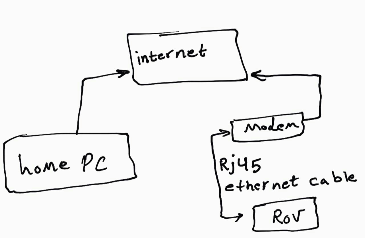

Hello friends
I want to connect to my rov via the internet to control it (from home)
My modem :
Please help me thank you
Hi
Is your ROV built from a Raspberry PI?
There are plenty of websites in google that suggest various methods to do this…(e.g. How to Control a Raspberry Pi Remotely From Anywhere In the World )
Clearly security is really important here as you potentially can expose your ROV/network.
I suggest doing some reading to find an approach that works for you.
