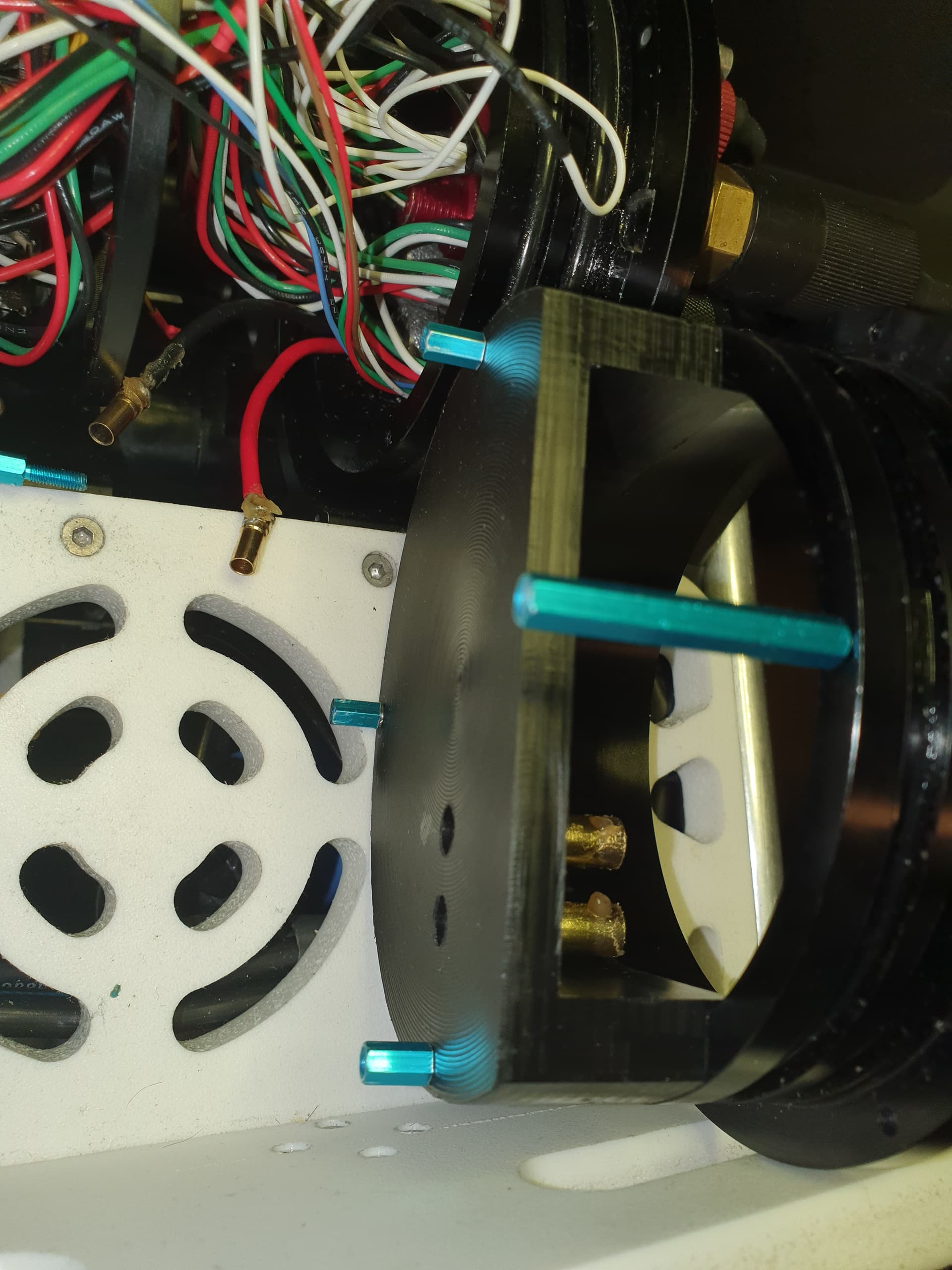

Inserts in the Foam,i have use stainless plate with 4mm threaded inside same for threaded bolt 4MM.
I have also made a collector box for water leakage,the intention was to use contacts from Amass on all wires but now i use Cobalt Connector on my bluerov2.
So i do not need that for all wires,only for battery cabel (Amass xt90 contacts)
If the Penetrator or battery cable is leaking the water will be in the water collector box and the Leak sensor will give alarm.
Also thought of making a cover on top so that the box had been completely closed.
