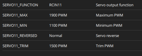

I have mounted a motor with brush on our robot with vectored6dof configuration. I am able to spin the motor with potentiometer by sending PWM input to the servo channel.

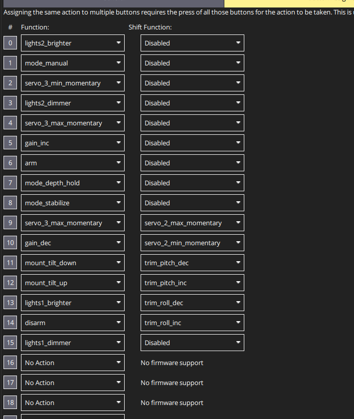

The problem is, when I try to move the camera by button, the attached motor is spinning at full level.

For now: Light is on channel 9, camera is on channel 10 and attached motor is on channel 11.
I put my channel configuration below.
And I have another problem too, when I attach the motor to channel 12,13 or 14 (as the above given screenshot) the attached motor does not work. What can be the problem of higher channels? Do I miss a configuration step?

Do you think that something on this python scripts can trigger this undesired movement of attached motor?
I will put the button configuration of my robot below:
