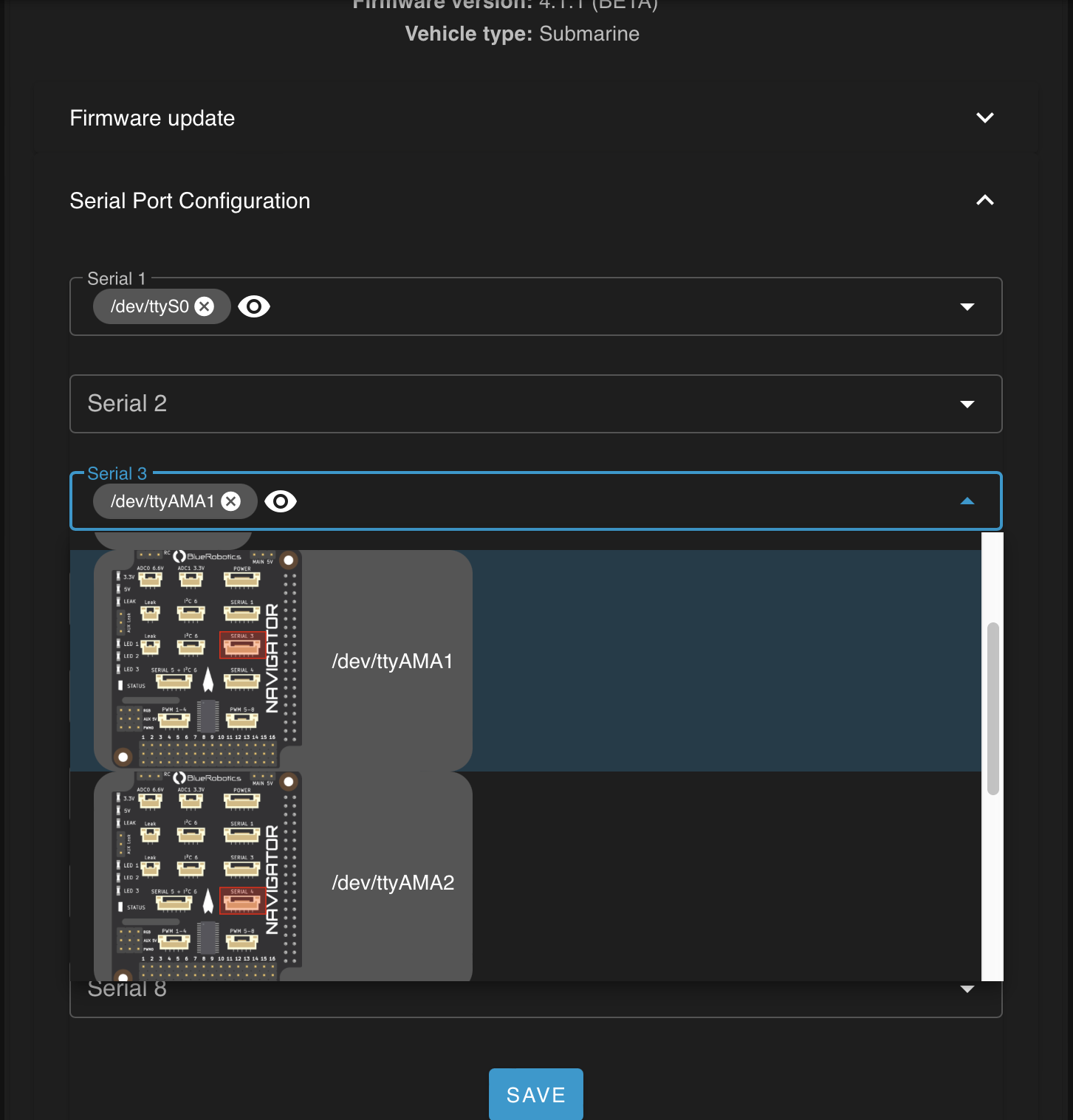

Since that GPS has a USB and not network connection, you’d simply set the Serial2 to correspond to the USB port you’ve plugged the GPS into, under the Autopilot Firmware menu (while in Pirate mode.) You may need two of those USB GPS, one mounted in each hull, to get things working with true differential GPS? You could setup the second unit as Serial3 in the same menu, and set the corresponding Serial# function parameters as described.

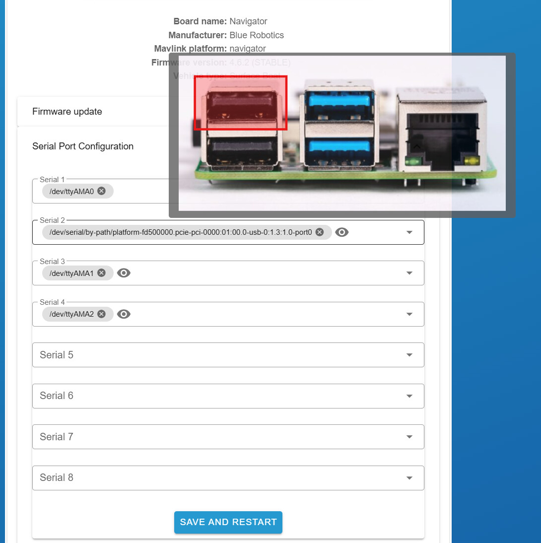

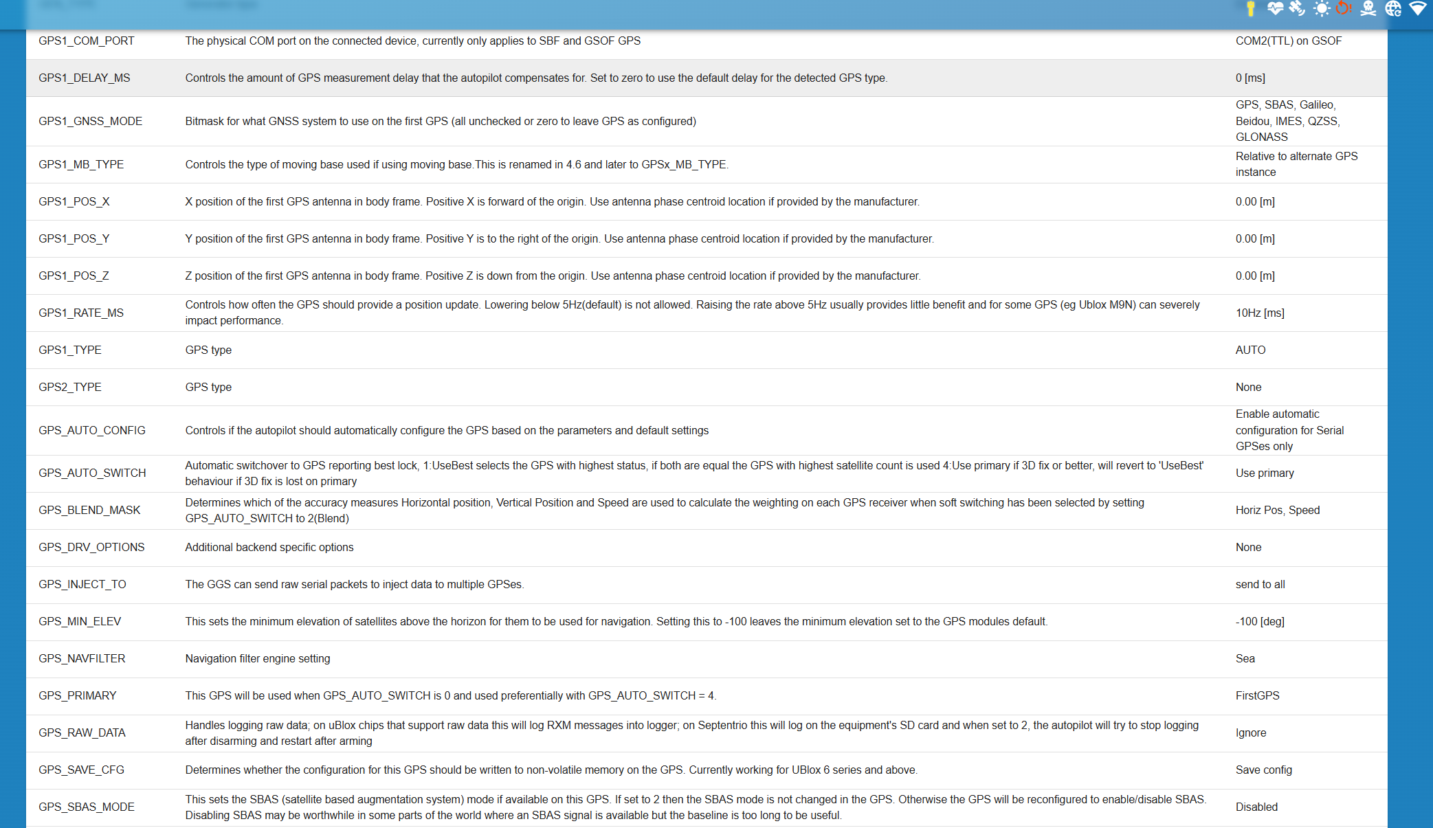

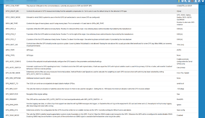

Now, I connected the GPS to the USB port, setting it to “serial 2” and my BlueOS “sees” it correctly. I want to use an RTK correction system from SmartNet hexagon service. I want my BlueOS to use only this external GPS (the model is TopGnss Top609bt-B). Could you indicate me what parameters I need to set on the options shown in the screenshots I’m sending you? I set the GPS baud rate to 230400 as recommended on various forums for the GPS data type. I wonder if I should set GPS 1 or GPS 2 as the only GPS? And above all, is it correct to select “NMEA type” even if my TopGNSS 609 is a ublox? and as “GPSprimary”?

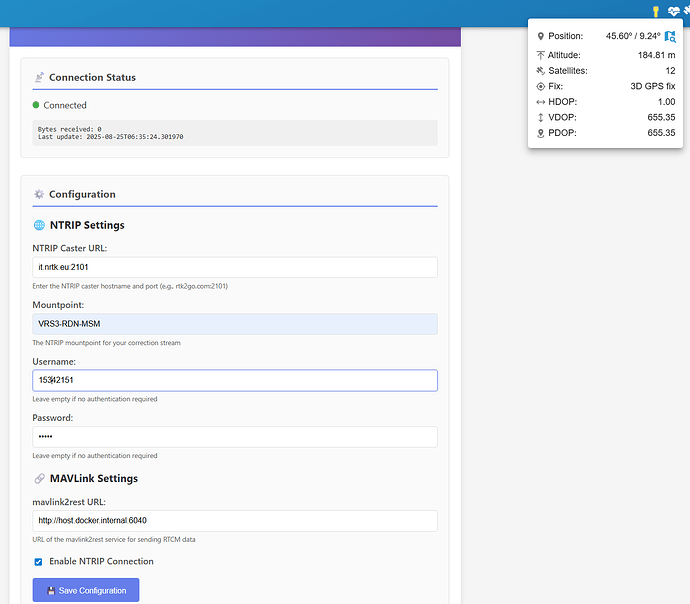

Currently, in “NTRIP RTK” extension data remains constant (e.g., Bytes received: 377
Last update: 2025-08-24T14:38:38.889909).
It seems to have almost been solved but the RTK is missing
I think I need to adjust something in the settings.
Thanks and best regards!
Federico

You needed to set the USB port to Serial2 under the Autopilot Firmware page, in Pirate mode - can you share a screenshot of how you have that configured? Specifically, here:
It’s best to leave the baud rate and type to auto.
The Ntrip Extension you mention needs a source for corrections specified - what have you put in there?
Those other parameters don’t need to be touched but you may want to input the GPS Pos X,Y,Z for your GPS location relative to the body frame center….
Yes, I confirm that I have set the port correctly. I set the USB port to serial 2, while I use serial 3 for Ping Sonar.
At this point, I’m wondering how I should set the parameters you see in the screenshots I’m sending. Specifically, to use only this external GPS, should I set it to GPS1 or GPS2? And what frequency is best for this type of GPS like mine?
as GPS Type I have to set NMEA manually, because if I set it AUTO it doesn’t detect it
And finally, the settings for my Leica Hexagon Smartnet correction network. It says it’s connected, but it’s not receiving data.
I think I need to set the ability to send NMEA data (essential for any RTK correction service), but I don’t know where to set it and how.

Have you set the Serial2 Function parameter to GPS? GPS1 can remain how you’ve configured it.
I don’t think the RTK extension you’re trying to use is compatible with other sources besides RTK2GO but @williangalvani will know for sure!

Hi Tony! yes, I set the GPS function to serial 2 and kept everything that way with GPS1. It sounds so strange that it is not compatible with the Hexagon Smartnet RTK service (https://hxgnsmartnet.com) because it is a traditional RTK correction service; for example, with the SW Maps free app (https://play.google.com/store/apps/details?id=np.com.softwel.swmaps&hl=it&pli=1) with the same antenna it connects and receives the Ntrip corrections. This app, however, works good sending NMEA data, which is essential for having correct return data and that is precisely what I don’t understand how to set up with Navigator. As for BlueBoat, no, I use a homemade boat and I purchased Pingsonar, Raspberry and Navigator with BlueOS from you. I only need to log GPS positions (RTK) and depth data; for now I don’t use automatic mission planning.
