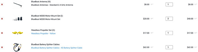

You can purchase each BlueBoat hatch and internal frame assembly withou electronics - this is likely your best bet from a cost savings perspective! 3D printing standoffs and large flat plates is unlikely to save you much money… You can get the 2 hulls with everything you need for less than $2000 (+shipping), and install your own control electronics! Note that 2x M200 BlueBoat variant motors are not included in the screenshots below as they are temporarily on backorder, so could not be added to the cart.
Even if it was possible to print all the internal hatch lid components, the savings would be negligible…
