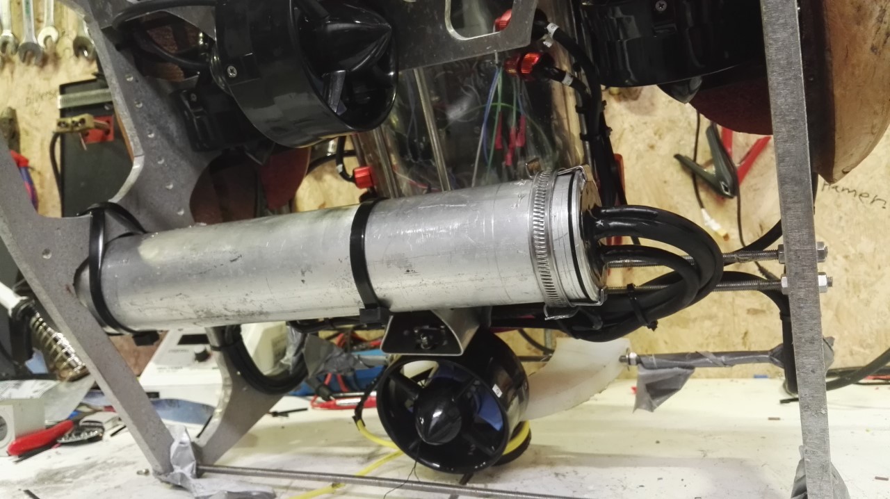

here is some of my new mods .
2x 80w led light
eksternal camera housing with wather tight servo for tilt .

Hi
I used a high torque servo from ebay
https://www.ebay.com/itm/MG996R-Torque-Digital-Metal-Gear-RC-Gross-Servo-For-Helicopter-Car-Boat-Model/263756770569?ssPageName=STRK%3AMEBIDX%3AIT&_trksid=p2057872.m2749.l2649
And i made a watertight enclosere on my CNC mill .
Cable penetrators form Blue robotics , and shaft seal from the Ikelite video housing .
drawing from Autodes fusion
Led light is 36v 100w led cip
https://www.ebay.com/itm/100W-LED-Chips-Super-Bright-High-Power-LED-Panel-Lamp-9000LM-100-Watt-Lamp-Light/401136725274?hash=item5d659cad1a:m:mAsqe7Anr0KdYOlVJMyDf5g
I use one step up power to suply both led chips .
I use a micro servo to adjust the voltage on the step up power .
current limitation set to suply max 160w .
https://www.ebay.com/itm/400W-Step-up-Boost-DC-DC-Converter-Constant-Current-Power-Supply-Module/282630656758?epid=2217498877&hash=item41ce1992f6:g:QRYAAOSwFWVZmlWc
There is a seperate enklosure with 12 18650 batteries ( 6s x 2 ) only cable with pwm, goes to the rov housing

HI
I used an old video housing for my ROV build
so I removed the shaft seals , and replased them with Cable seals
