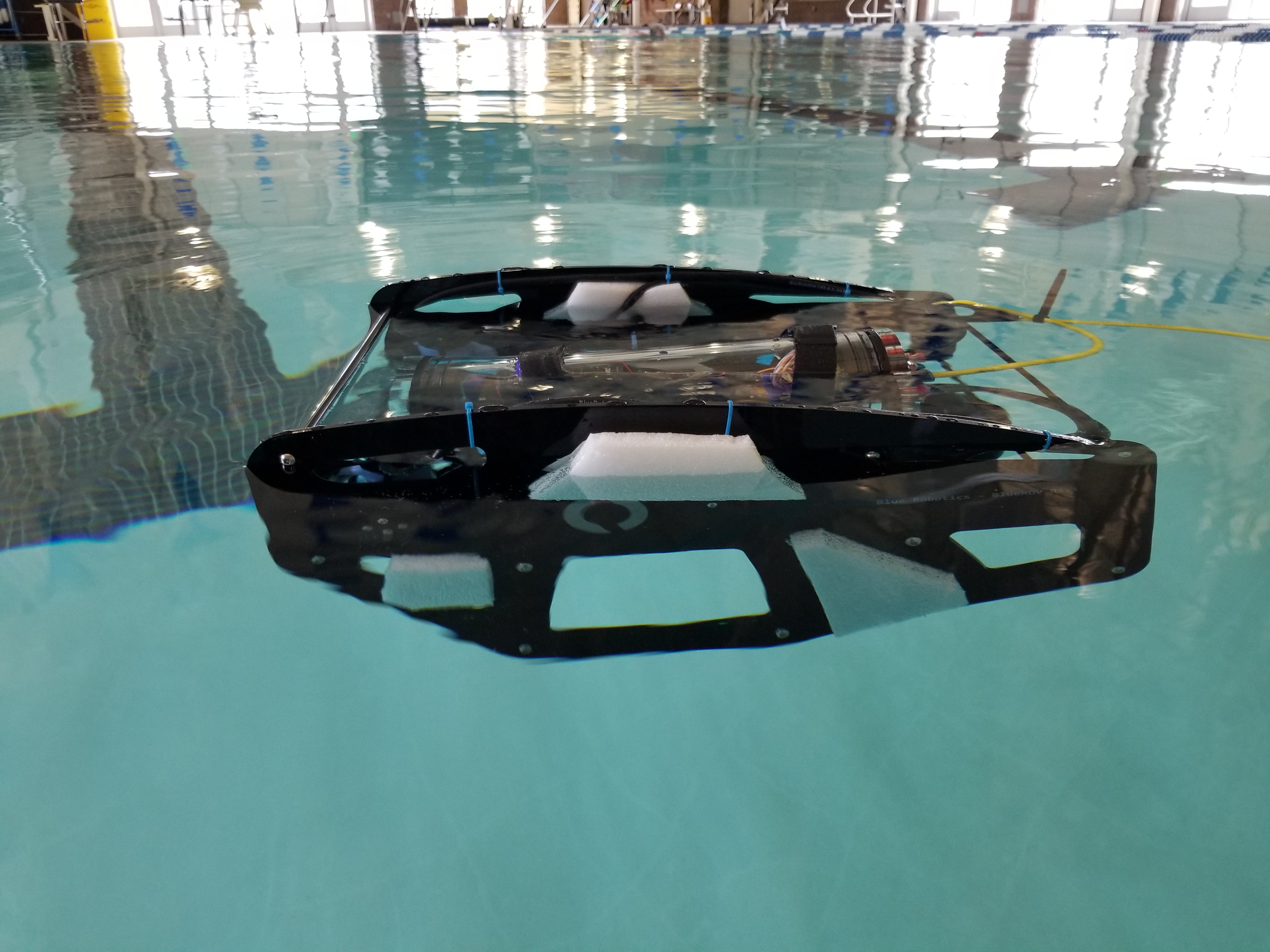

What level should our BlueROV be floating at?
Matter of opinion depending how you work whith the ROV
I would say much heavier then picture.

Thank you.
I’ll take out some of the buoyancy foam.
Put weights on bottom to balance n then buoyancy can be used for heavy lift later if needed
