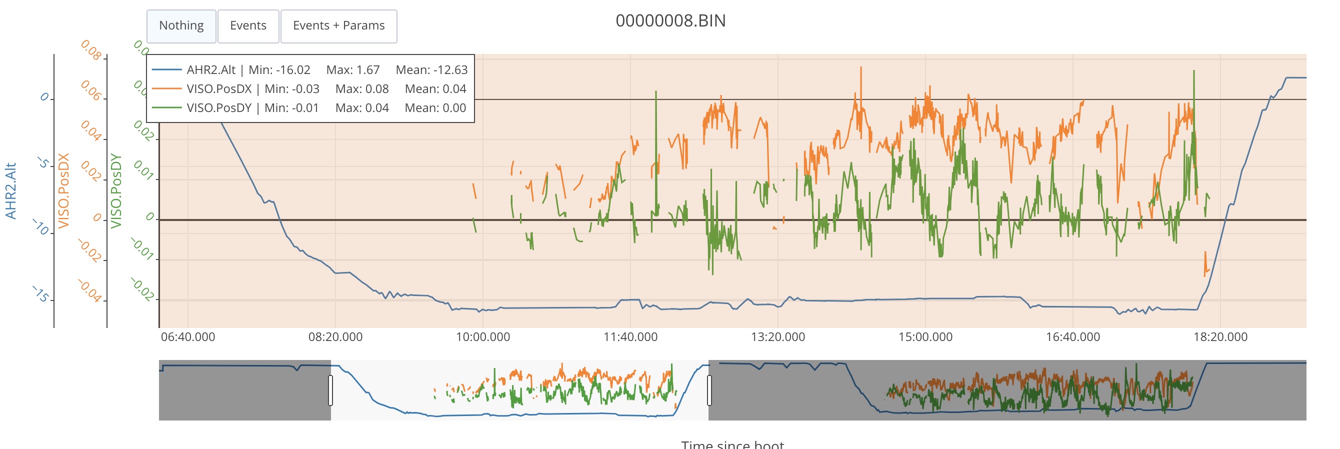

We’ve recently experienced some issues with maintaining a DVL fix on our WaterLinked A50. Noticed we’re seeing dropouts in VISO signals c.f. to previously.
Bad:
-vs-
Good: How things looked back in May. No gaps. Solid signal as soon as in the water:

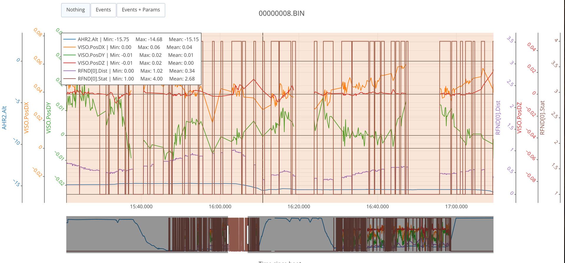

Thanks for the prompt response @tony-white . Nothing obvious showing when we Ping the DVL, but I will check the network connection. I’ve added RFND[0] to these plots. Status seems to switch between NoData (1) and Good (4). Would we expect to see NotConnected (0) if there was a network connection issue?
Bad (now):
Good (back in May):
