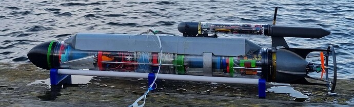

My two friends Adam, David and I decided five years ago that building an AUV would be a cool hobby project. The goal was to autonomously, and under water (mostly), circumnavigate a small islet about 600 meters offshore.
Fast forward five years and here it is. Ålen. Or “The Eel” in English.
Last month, to our great joy, we successfully completed the mission. Friends and families were there to cheer us on, and we had a big TV set up that showed some telemetry during the run.

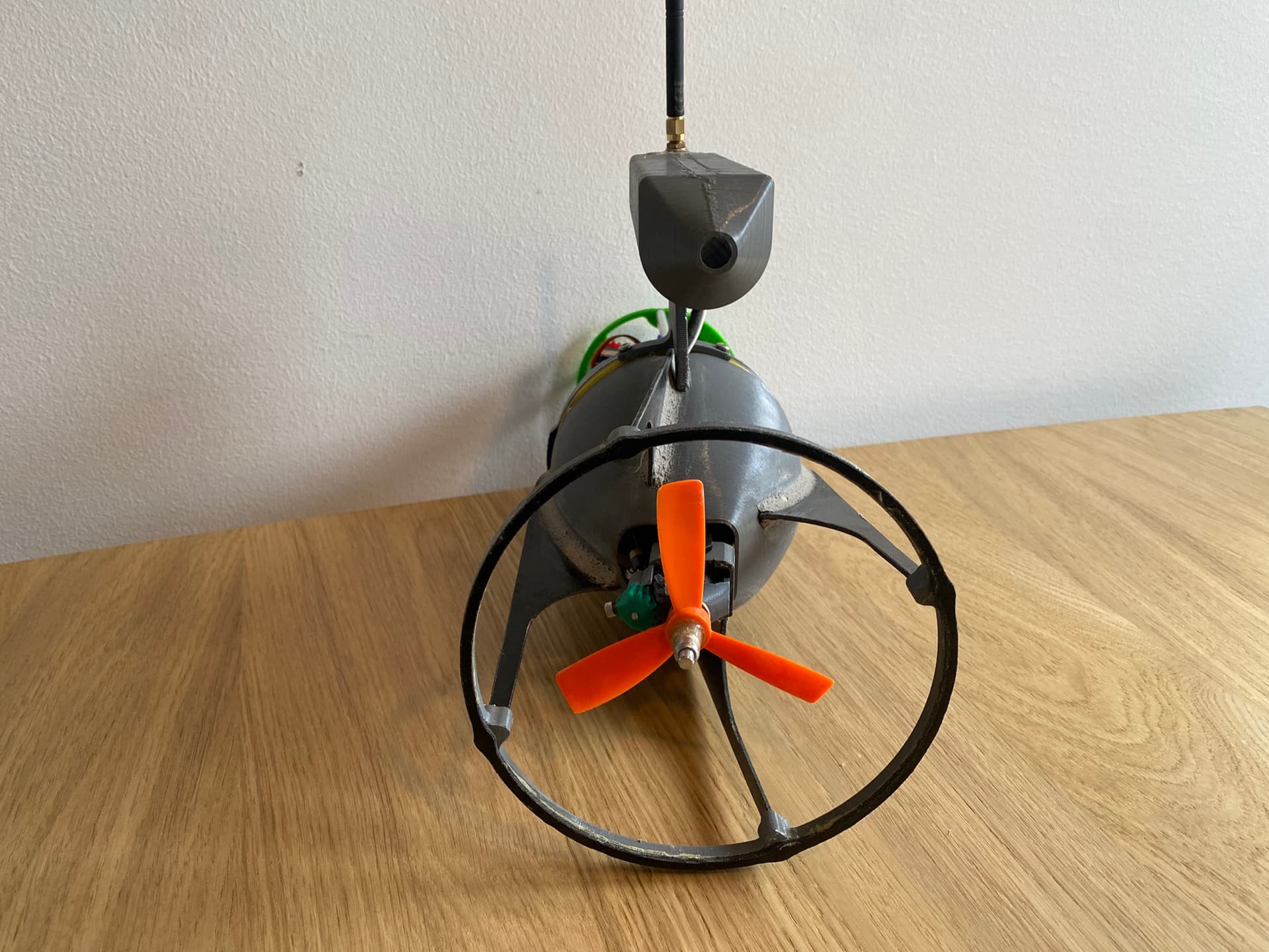

Propulsion and maneuvering
Here we let our mechanical mind go a bit wild before coming up with this idea. We thought it would be cool if we could combine pitch and yaw motion with only one control rod.
So, there is a cheap but powerful enough geared brushed motor in the dry WTC with a shaft going through the endcap and a small radial seal. Then a universal joint connects the shaft to the propeller. The universal joint in turn is coupled with a linkage and a gear that basically connects to the control rod. When the control rod is moved in/out this steers the propeller in yaw. And when the control rod rotates, it controls pitch.Two servos, one on top of the other does the moving and rotating.
We have since refined the servo setup and made it more rigid, but the basic principle remains.
To prevent the torque from the motor to roll the AUV, we use a long 10x10mm stainless steel bar to act as a keel. Also, the fixed fins on the back of the AUV are angled slightly to counteract the roll when at some speed. Max speed at the moment is 1 m/s.
Pros:
  • Works surprisingly well to thrust vector the propeller and gives great maneuverability
  • One less control rod to penetrate the hull which is always a good thing.
Cons:
  • Having control rods and shafts at all penetrating the WTC is always risky if not done properly
  • The mechanism and the universal joint itself needs to be made more rugged or encapsulated in some way to protect it from debris and the hard environment of the ocean.

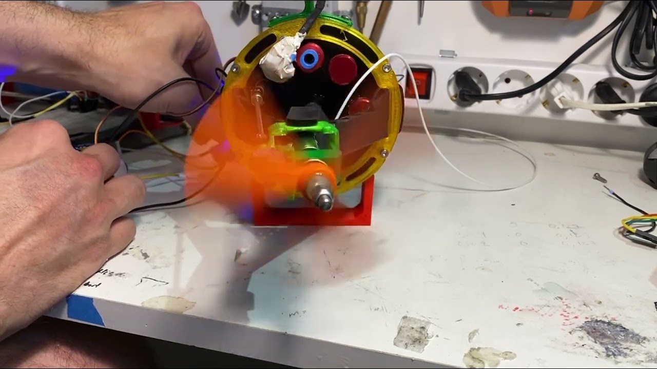

Again, we (or I, since I’m the hardware guy of the bunch) got to design some fun mechanisms. The release mechanism is based on the mechanism used for quick releases. It’s essentially an “over center mechanism” that needs very little force to trigger a larger load.
This was necessary since we wanted to use a magnet attached to a servo inside the buoy’s WTC to trigger the release and eject mechanism attached to Ålen.

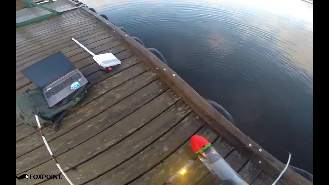

Inside the emergency buoy is an arduino MKRWAN1310 with a LoRa module for communication, a GNSS receiver, a servo, a battery and some LEDs. It is set to trigger if the GNSS receiver doesn’t get a satellite fix in 5 minutes. For this reason, during the run around the island, our longest dive was just under 2 minutes.
The range of the LoRa communication was tested to at least 1 km with the buoy floating really low in the water and in line of sight to the receiver. This was going to be good enough for us.
Here is another video of testing the system. We did do successful tests down to 20 meters which would be around the max depth of the island run. The spool was loaded with 30 meters of line.
In the future, I hope to get into electronics some more, because it’s so much fun. The buoy won’t be separate modules connected by wires then, but instead integrated on a circuit board. This way the buoy can be made sooo much smaller. Now it’s more like the space shuttle piggyback on a 747 :slight_smile:
