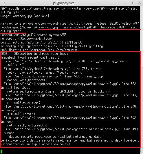

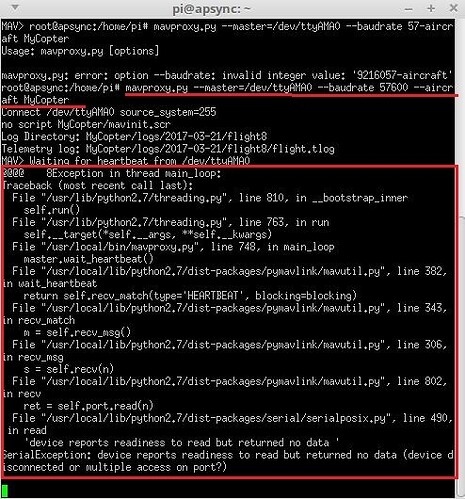

When I used this command
“mavproxy.py --master=/dev/ttyAMA0 --baudrate 57600 --aircraft MyCopter”
It showed these information like the picture
Does anyone know how to solve it?
I appreciate your help!
DS
How is the Pixhawk connected to the Raspberry Pi? USB? If you are using USB, you should use /dev/ttyACM0 for ‘master’, if you are using the RX/TX pins on the Raspberry Pi, make sure you have disabled the console login on the serial interface.

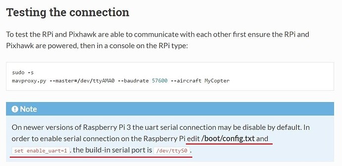

If I disable the console login on serial interface, the “enable_uart” will be set 0.
But this note show I need to set it 1
How can I do?

You need to do two separate things:
  1. Enable the serial interface with ‘set enable_uart=1’
  2. Disable console output on the serial interface, there are instructions to do this here.
-Jacob

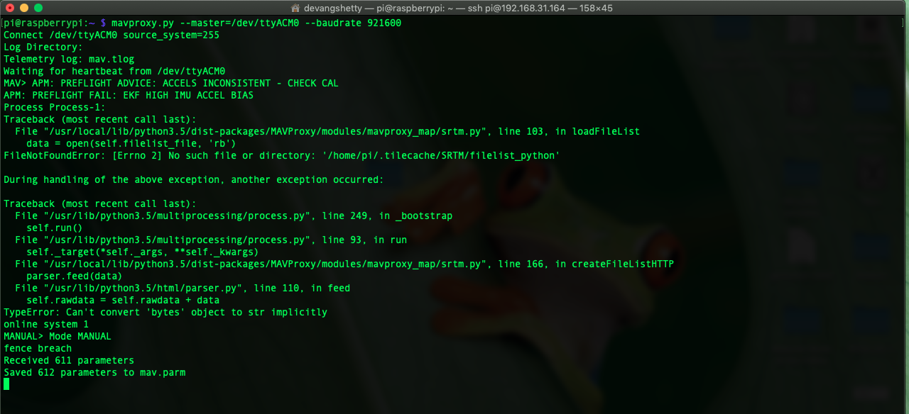

Guys please help me resolve this issue, I have ssh(ed) into my pi and downloaded and installed all the libraries, my Pixhawk in connected over USB but I’m getting this error please help me resolve it.
I am following the standard Dev docs to make the connection between the Pi and the pixhawk
Try using python2
Yes! That was the problem. But my mode is still not changing to STABILIZED.
