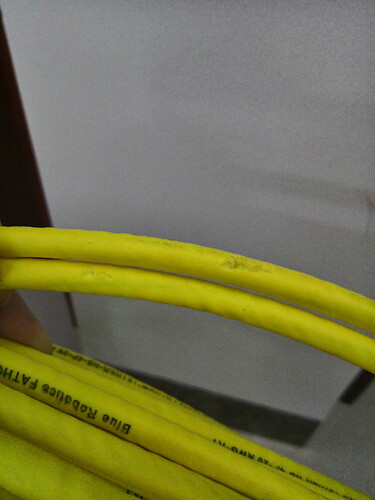

Tether is scrached a little bit by rock, do I need to repair it? How to repair?
Thank you very much!
Hi Ooyama,
As long as the scratch does not go all the way through the jacket, you should be fine. If you’d like to repair it, I would suggest using an adhesive-lined heat shrink to seal it and cover the area.
