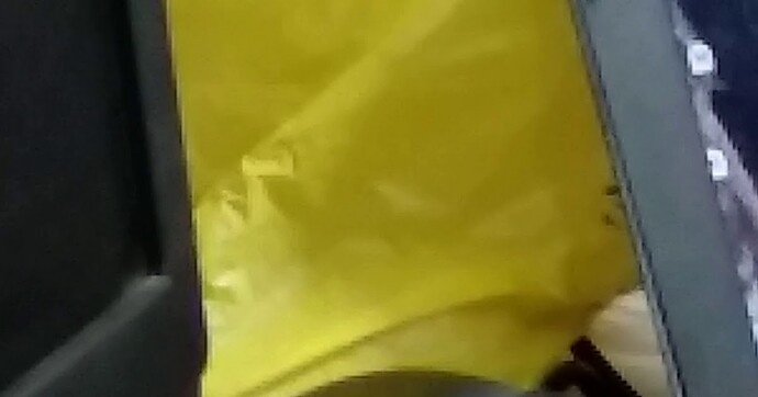

Using T200 with Pixhawk and ardusub. This particular thruster is not rotating making a jerking motion and stops after a few seconds and only the licking noise comes. Please Help.
Video link is attached:
