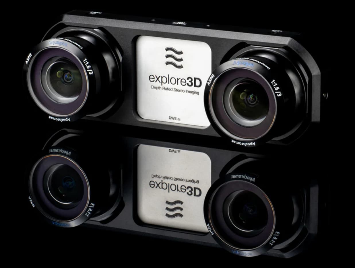

Subsea Stereo Vision System
Introducing DeepWater Exploration’s latest innovation: the explore3D. This is the world’s most affordable and smallest subsea stereo camera system, offering a total resolution of 4MP with a Global Shutter sensor, all through USB 2.0 output. It features Frame-Sync capability with nanosecond accuracy and incorporates our proprietary Aquagon™ lens technology, which eliminates distortion and chromatic aberration, making it perfect for stereoscopic vision. These advanced features are packaged in a user-friendly design, available in configurations rated for 1,000, 6,000, or 12,000 meters of water depth. The baselength of the stereo can be configured for optimal 3D imaging at various working distances.
Utilizing two stellarHD cameras on a precision-calibrated bracket—equipped with a modern Global Shutter sensor and proprietary PCB—you can capture synchronized video like never before. With our frame-syncing technology, you can achieve simultaneously synchronized video at 60 FPS.
Furthermore, as a UVC-compliant device, the explore3D is the first plug-and-play stereo vision capable subsea system. This makes explore3D the ideal choice for anyone seeking to develop a modern 3D data capture system.
Integrate this into your existing 3D reconstruction/scanning, SLAM, point-cloud, and/or other software, or keep an eye out for the new DeepWater Exploration software platform later this year.

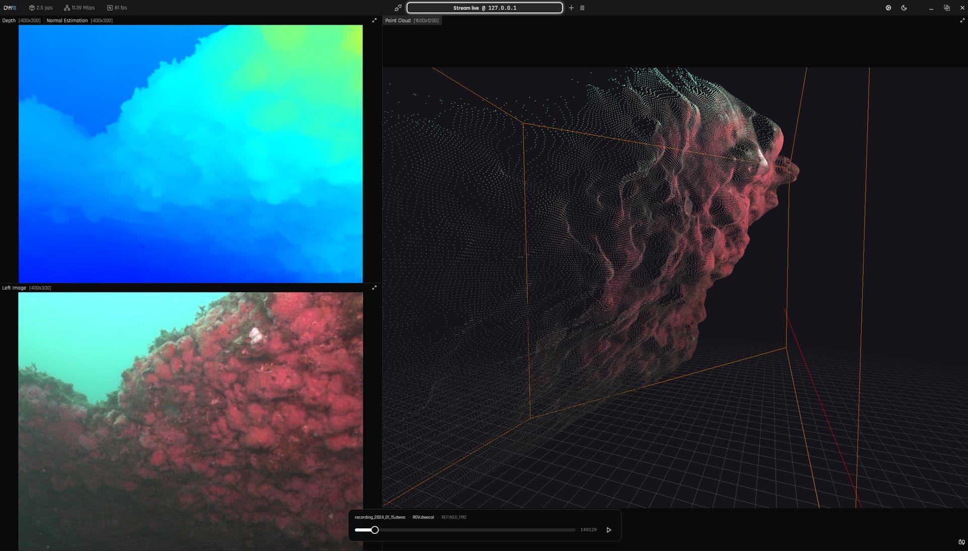

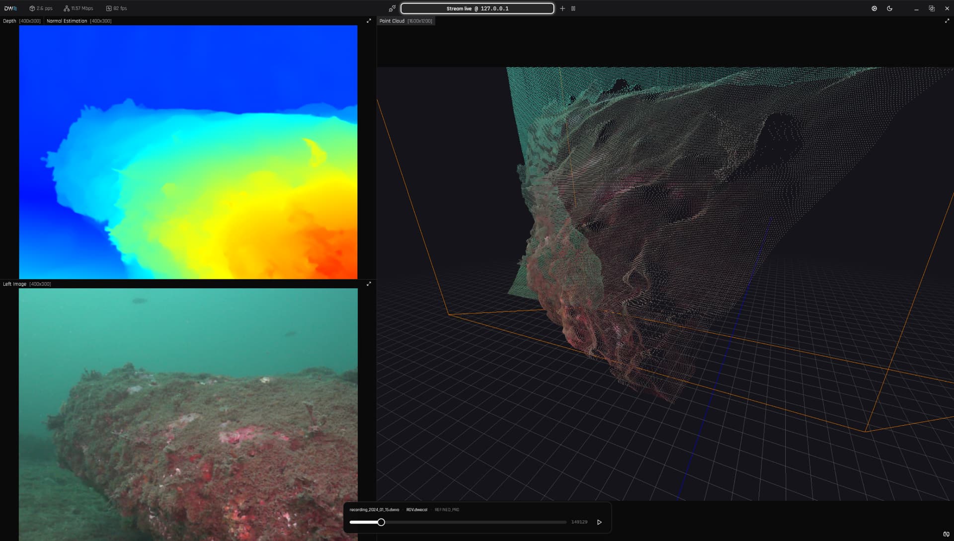

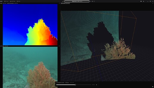

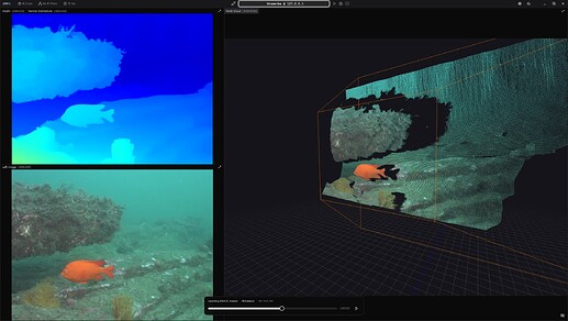

Hi All!
Our team has been working hard in perfecting our stereo system, explore3D, and we finally have some exciting news to share!
  1. Complete hardware redesign. Now featuring a hard anodized unibody design for higher strength and rigidity.
  1. Real-Time 3D Point Cloud Generation, Finally! Here are some of the incredible images captured by the explore3D:
We are continuing to test and improve the platform as we speak. Once we have even more data and updates, we will let you know!

Hi all!
Quick update, we have done some extensive tests of our point cloud real-time measurement accuracy.
You can see the results here:
Our conclusion is that as long as you can see the points clearly, you can get the same accuracy as a ruler.
We will continue to do more testing and update further as we gather more data!
