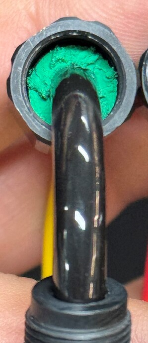

When using Wetlink, I noticed that the Seal appears to be damaged. It has only been used once. Is this normal?
Hi @Joe22 -
Did you have a leak? Generally the seals are only one-time use, due to compression and abrasion of the plug preventing re-use (as you’re seeing there.) If you opened and intend to re-assemble, it may be worth replacing that seal, but if you’re staying at shallow depths it would likely be ok…
Hi @Joe22,
To clarify, the reuse recommendations on our product page technical details, and in the usage guide, specify that
  1. the colored compression seals (and previously-compressed regions of the cable jacket) should not be reused, but
  2. the metal bulkheads and plugs can be reused (when resealing a cable) up to 3 times, and
  3. the assembled WetLink penetrator + cable can be moved around and reinstalled indefinitely (although when reinstalling you’ll need to inspect the o-ring and replace it if necessary).
