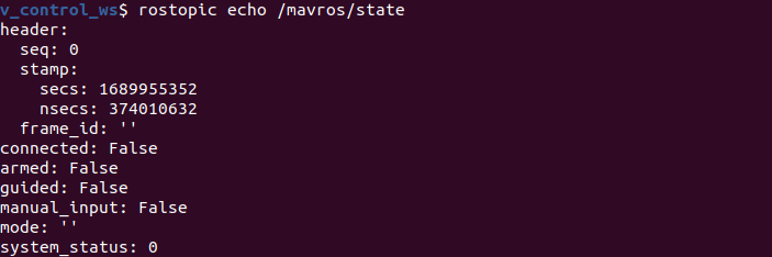

The camera isn’t moving at all. When I send the command I try to observe the behaviour of the camera both on the Bluerov2 itself and in QGroundcontrol. And it doesn’t move.
I also tried some different commands and the bluerov2 doesn’t react accordingly.
Thank you for sharing the link, I’ll have a look at the thread and contact you ASAP.
I looked through the suggested thread and changed the code, but the camera isn’t rotating. Thinking whether this can be because of the mode or not? Tried for armed and disarmed the BlueROV2. May you help me regarding tilting of the camera?
