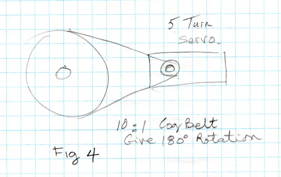

It is always a problem coupling to the shaft.
I have been using sprockets and cog belts from The Robotshop (Fingertech products). They could couple to a 5 turn Servo motor to increase the power.

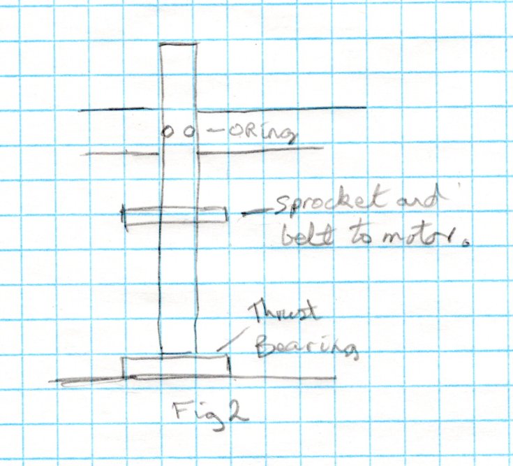

Another way to deal with a single ended shaft is to put a thrust bearing inside at the opposite side of the container. However the shaft needs a belt to turn it and gets in the way of the servo making for a very big container.
