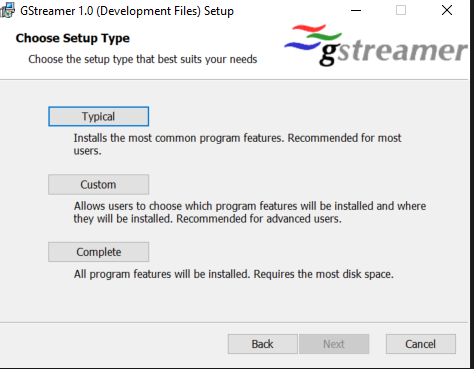

Hi Eliot,
When i download the MNSW installer from here (Download GStreamer)and run it, it doesn’t give me any options to uninstall the previous version. It gives me the classic pop up.
  • How did you install it originally?
    • I ran the original installer a second time and it gave options to change which components were installed, or remove the installation.
  • Do you still have the original installer in your Downloads folder?
  • Is it possible you originally installed a different version?
If you can’t get the installer to uninstall it for you then it’s likely sufficient to delete the C:\gstreamer folder, and the MSVC GSTREAMER_... environment variable (likely something like GSTREAMER_1_0_ROOT_MSVC_X86_64), after which you can try following the steps outlined above :slight_smile:
