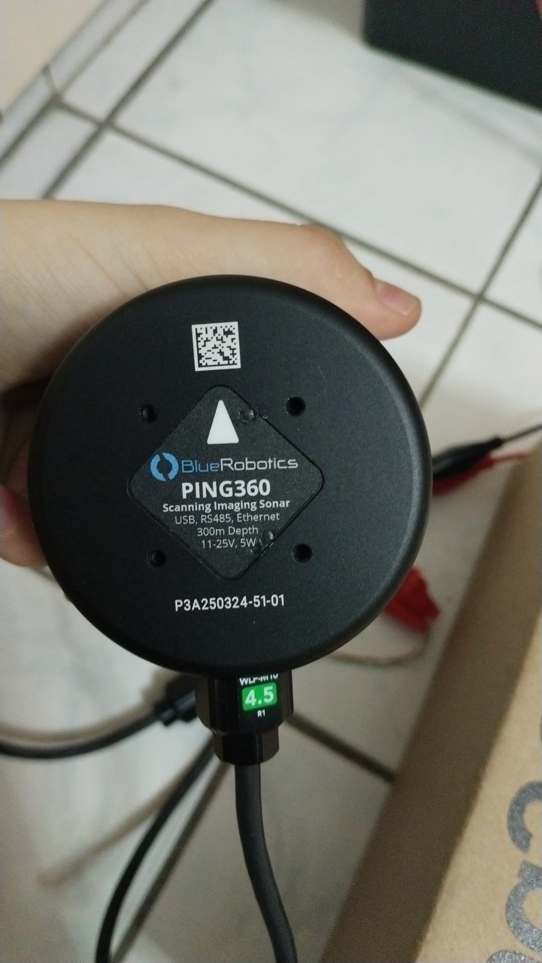

1. Orientation Reference
I have attached a photo of my Ping360 unit. Does the white triangle arrow on the back casing represent the physical 0-degree (forward) reference?
I want to confirm this to ensure my coordinate frame transformations are correct relative to the sonar body.

Hi @beyza,
No - the 0 angle is where the cable enters. The firmware doesn’t have great handling of auto_transmit functionality for sector scans pointing towards the zero / full-rotation threshold mark, so I assume the front was set in the opposite direction to minimise potential issues with that.
