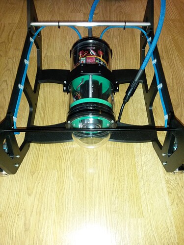

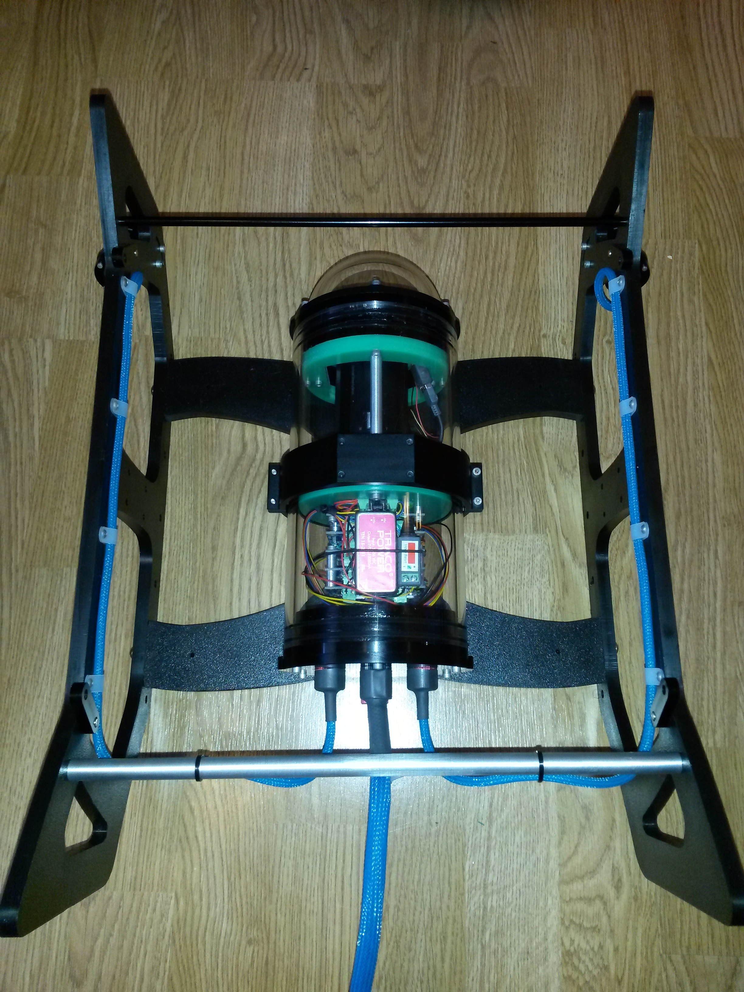

Hello
I use a Sony HandyCam HDR-CX450 with two arduino mini pro and RS-485 (two wire for video and two wire for RS-485)

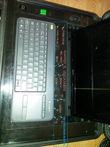

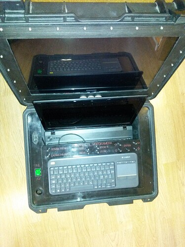

I have access to all camera button,on the surface.
I use a 8 pin SubConn Micro contact,easy to remove the Payload Skid from Bluerov2.
