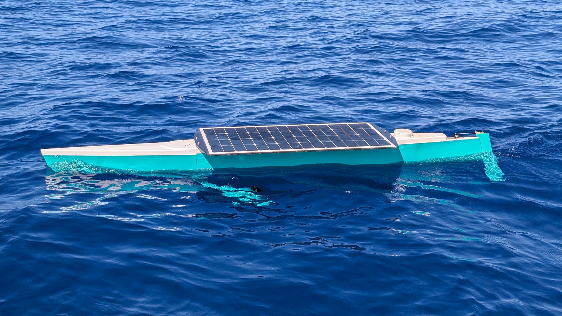

I’ve been working on an oceangoing ASV for years as a side project to demonstrate some of the marine robotics components we make at Blue Trail Engineering. I finally got it done and launched it on February 8, 2025 from Avila Beach, California. The original destination was Hawaii, but the boat outperformed expectations and ended up making it all the way across the Pacific. The total distance traveled was 13,322 km, which I believe is a record for a solar-powered autonomous boat.
Special thanks to Blue Robotics’ own @tony-white for taking the time to go out and meet the boat as it passed Hawaii! He’s the one who snapped this picture.

Aside from all your other accomplishments, another amazing thing is the lack of marine fouling in the picture from Hawaii. For a hull that has been in tropical water, it’s remarkable.

Hi @psupine , yes, it was remarkable how little fouling there was. But it’s possible that the fisherman who took it out of the water cleaned it off. Not sure.
