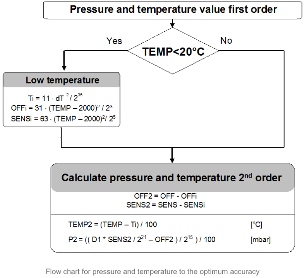

I am looking at the BlueRobotics MS5837 library. I am comparing conversion calculations shown in the TE Connectivity manufacturer conversion math and comparing it to the Blue Robotics conversion code.
For temperatures above 20degC, there TE Connectivity does not seem to show any 2nd order conversion. The Blue Robotics library is using a 2nd order conversion algorithm?
Can anyone explain where the Blue Robotics 2nd order conversion algorithm comes from? Here is screen shot of the TE Connectivity 2nd order chart.
TE Conn
