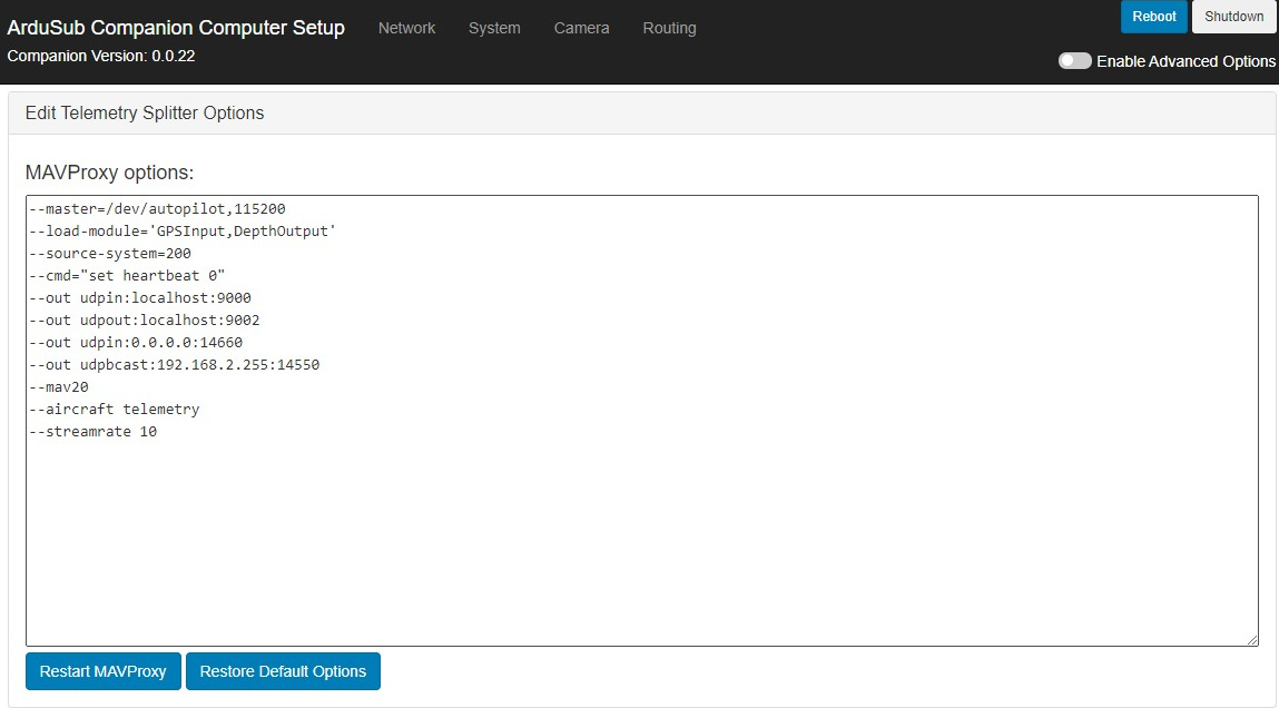

What do you see on http://192.168.2.2:2770/mavproxy? The high delay was linked to a high streamrate and too many endpoints there.

What is the cpu usage like?
Try removing the line ending in 14660 (ping360 heading integration) or 9002 (mavlink2rest, this will disable mavlink2rest)
