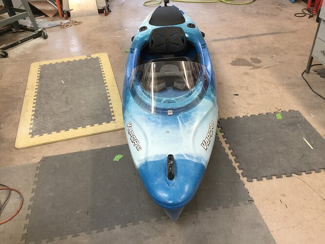

Also a change in plans around the motor placement. Going to do a test with them mounted at the rear of the kayak instead of the pontoons. If it allows for differential steering at the rear it will make for a more flexible cleaner setup.
Working on the hardwired Arduino controller setup next…
Posted this in another thread but some updates…
Plan now to mount the T200 at the rear of the kayak as opposed to on the pontoons, makes for a simpler cleaner setup. Hopefully can get enough separation of the 2 T200 to still allow for skid steering. Motors will be mounted on an inverted PVC Y off the rear rod mount.
I played a lot with trying to increase my watercraft’s speed. At one point I was putting out 4 HP (and melting solder connections) with my non-Blue Robotics experiments. I then discovered https://en.wikipedia.org/wiki/Hull_speed and realized no amount of power would let my boat go faster than 4 knots.
The T200’s put me in that 4 knot range and I haven’t done the detailed testing to see if I can programatically back off on the throttle if I’m wasting any power.
Some updated pics of the pontoons and mockups of the T200 mounting & placement.
Some updated pics of the Arduino controller setup. Hopefully be water testing this week or next.
